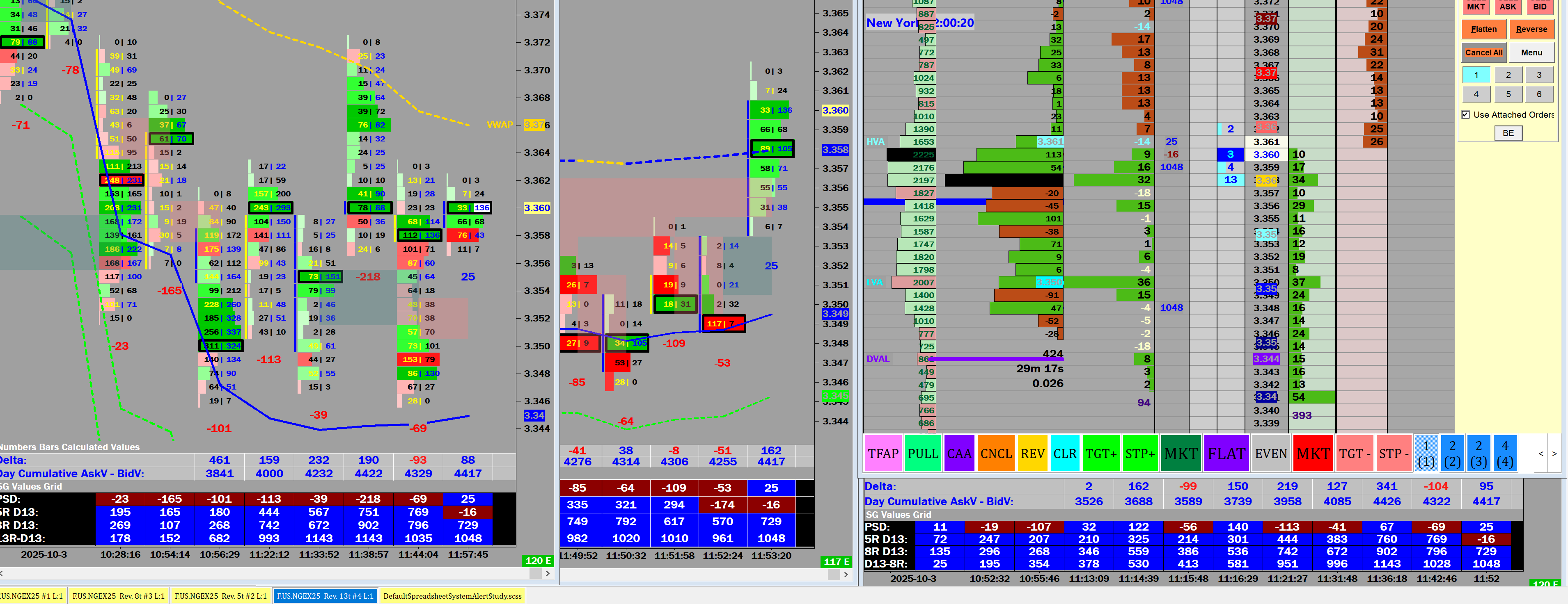

frederik at simple system trading has an indicator in his free bundle package that may do what you are looking for...allows you to assemble subgraph values in a grid beneath below price...SG Values Grid
https://www.simplesystemtrading.com/
imageCapture4.PNG / V - Attached On 2025-10-03 16:04:06 UTC - Size: 465.49 KB - 306 views

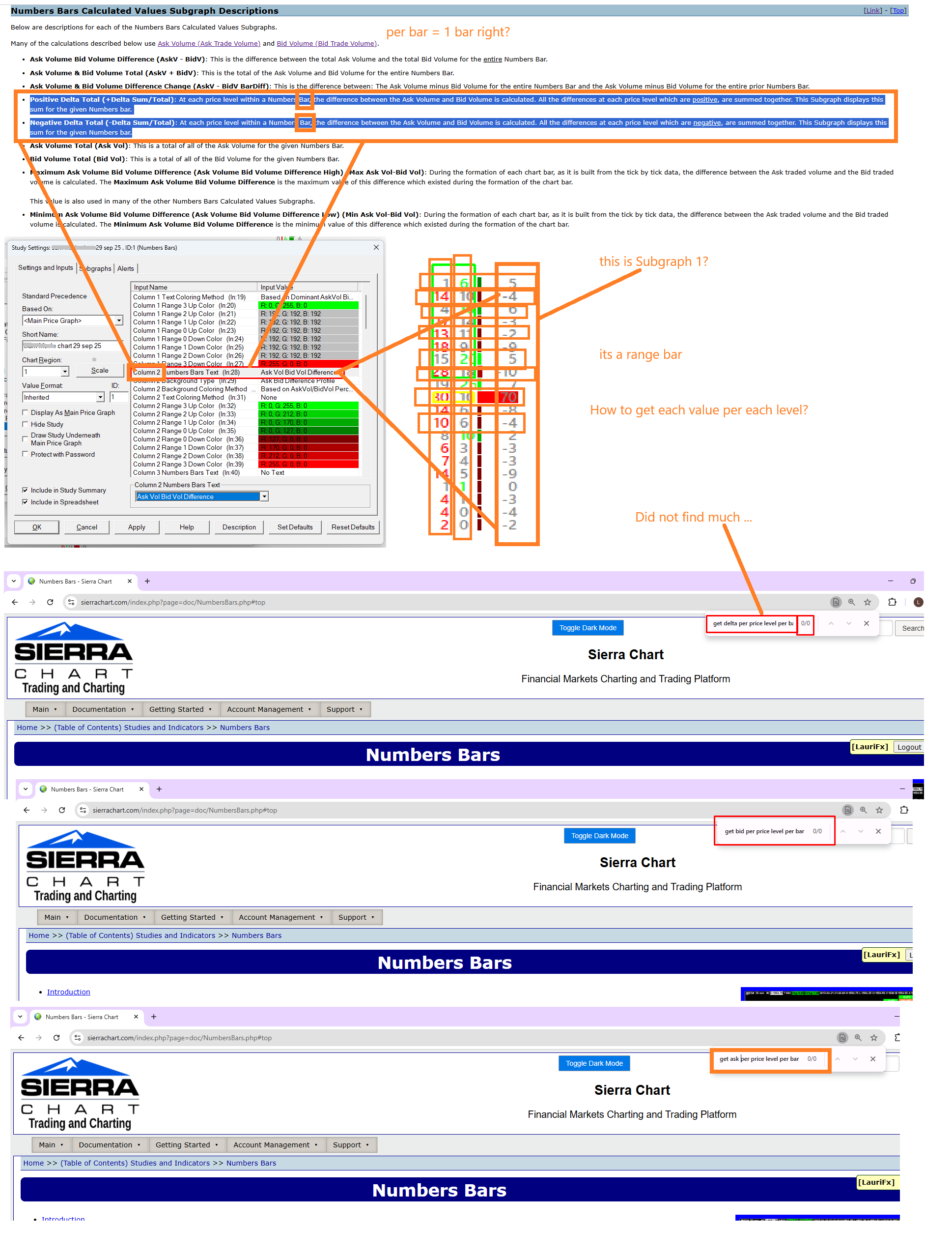

Thank you... C attached... if you could guide further? ...so the other study ID2 can calculate whatever the settings are requiring to calculate. Thank you.
have to use thisone, right > ACSIL Interface Members - Functions: sc.GetStudyArrayUsingID() ?
Date Time Of Last Edit: 2025-10-05 07:31:46
imageSC Numbers bars help docs vs settings vs chart .png / V - Attached On 2025-10-04 10:30:36 UTC - Size: 563.89 KB - 305 views
[2025-10-05 10:31:32]
User431178 - Posts: 910
You can't access that data via subgraphs, you need to use the volume at price data.
ACSIL Interface Members - Variables and Arrays: sc.VolumeAtPriceForBars

User265694 - Posts: 7
Hi, How to get values - price bid ask delta every tick level - from n number of previous bars? Thnx.
[2025-11-14 18:28:05]
You need to set the Intraday Bar Period Type to Number of Trades Per Bar:
Chart Settings: Bar Period Type (List) (Chart >> Chart Settings >> Bar Period >> Intraday Chart Bar Period Settings)
And use a value of 1.
Thank you, I have a footprint / numbers bar chart (bid-ask-delta visible) of 200 delta. And I want all values of every tick level from previous bar (200 delta) into the study. Seems study cannot get / fetch the values from previous bar? > keeps telling me: Code 8998 full recalculation cannot enter order until new bar begins.
imageLog Curs to SC supp 14 nov .png / V - Attached On 2025-11-14 19:06:08 UTC - Size: 299.92 KB - 213 views
[2025-11-17 22:00:41]
We do not understand this:
Every bar within a Numbers Bars chart, is for that chart bar itself. Never the previous one.
We do not know the relevancy of this to the question:
That error simply means, that when the study was being fully recalculated, order entry is not allowed.
