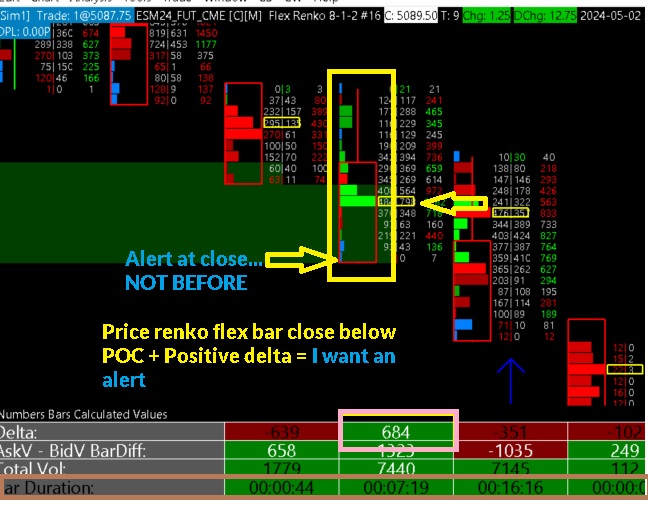

Misanirina - Posts: 49
Let do it simply.
If renko flex bar (price) close below POC with a positive delta = I want an alert (see the picture attach).
I cannot find the good formula, can you please help me.... i WOuld like insert the alert formula inside Number of Bar calculated Value Study.

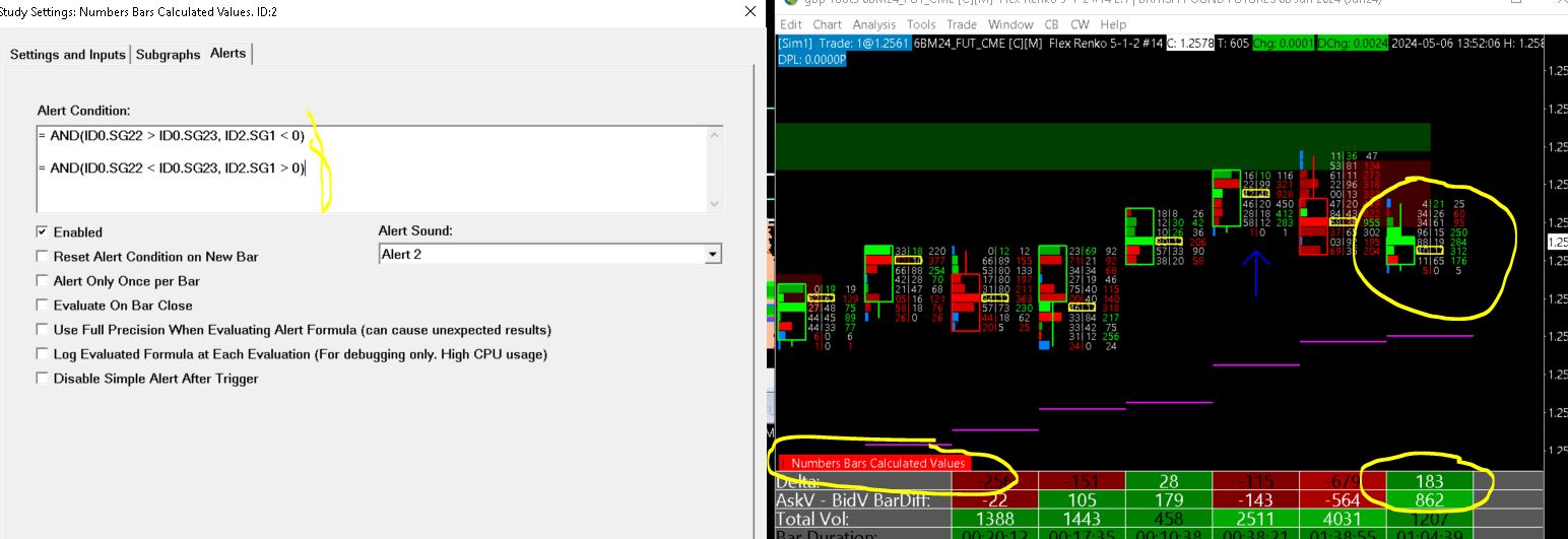

[2024-05-03 10:08:32]
Can i do alert formula with inputs data ? like In:71 or In73 ?
[2024-05-03 15:33:47]
This formula looks generally correct:
= AND(ID0.SG23 > ID0.SG22, ID2.SG1 < 0)
But according to the image you provided you want the close to be lower than the open, so you would have to change your subgraphs around, to be the following:
= AND(ID0.SG22 > ID0.SG23, ID2.SG1 < 0)
[2024-05-06 11:54:00]
Its not work.... it give false alert... i don't understand ( see the picture in attach )
image6.JPG / V - Attached On 2024-05-06 11:53:56 UTC - Size: 109.09 KB - 269 views
[2024-05-06 14:38:28]
What you are seeing is correct for the way you have the formula setup. If this is not what you want, then you need to modify the formula to be what you need it to be.
