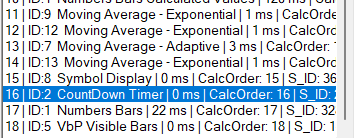

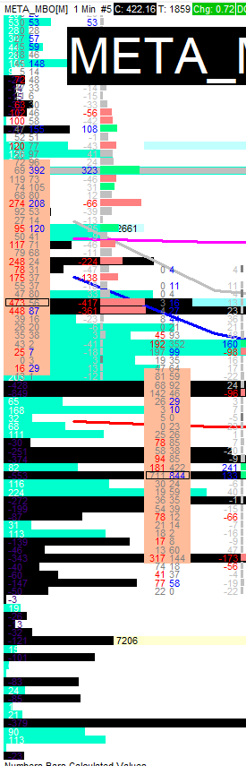

how to move volume by price study over the footprint candles? as you can see in the attachment the study order is correct. thank you

The Numbers Bars study becomes the Main Price Graph, so you need to change the setting on the Volume by Price study for "Draw Study Underneath Main Price Graph" to not be enabled. Refer to the following:
Chart Studies: Settings and Inputs Tab >> Draw Study Underneath Main Price Graph (in the same Chart Region)
