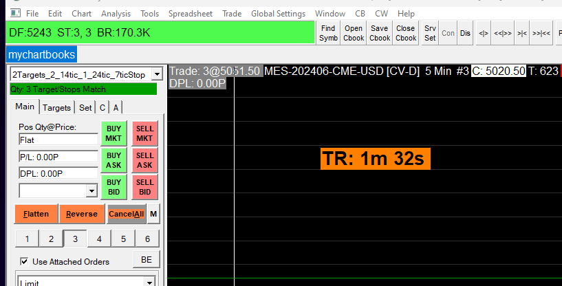

I experimented with replay yesterday, but now can't get live streaming market data. Replay window is closed. Simulation is off. The only thing data feed related I remember changing is days of data historical. I use the Denali feed. Data feed is set to SC Data All Services. It is green. One chart status says [CD-V] which I think is supposed to say [M]? The last chart time I have on any 'overnight' session I have is when I stopped the replay and closed the window, and also the software. I just don't know where else to look.
imagechart.png / V - Attached On 2024-04-22 13:24:13 UTC - Size: 33.58 KB - 192 views

That is not the correct symbol. That is an Interactive Brokers symbol.
You need to change the symbol of the chart to the correct symbol. This can be done through Chart >> Chart Settings >> Symbol.

I use Denali (was, want to) for chart data but the broker is Interactive Brokers. When I pick a symbol that is what comes up for ES Micro June. I see options and spreads with Denali, but the only ES Micro june contract in the screen shot. I guess when I set it up I got lucky as it was working, but can't figure out how to fix what I broke.
[2024-04-23 01:53:00]
Close all of the Chartbooks with "File >> Close All Chartbooks".
Open a single chart for the symbol you have an issue with through "File >> Find Symbol". Tell us that symbol of the chart. Tell us about *one* symbol only.

2024-04-23 14:46:41.353 | Denali Data Feed | MarketDepthIsSupported: 1
2024-04-23 14:46:41.353 | Denali Data Feed | Restarting real-time data updates for symbol: MES-202406-CME-USD -> MESM24
2024-04-23 14:46:41.478 | Denali Data Feed | Received security definition for symbol MES-202406-CME-USD
2024-04-23 14:46:46.152 | HD Request # 8 | Downloading Intraday chart data for MES-202406-CME-USD to the file MES-202406-CME-USD.scid. Service: cme
2024-04-23 14:46:46.152 | HD Request # 8 | Download start date-time: 2024-04-23 14:46:21.000000. File last date-time: 2024-04-23 14:46:21.387000
2024-04-23 14:46:46.153 | HD Request # 8 | Using server: ds13.sierracharts.com port 10149
2024-04-23 14:46:46.168 | Socket (3) | Creating socket.
2024-04-23 14:46:46.168 | Socket (3) | New receive buffer size: 0
2024-04-23 14:46:46.168 | Socket (3) | Connecting to IP: 38.142.170.155.
2024-04-23 14:46:46.338 | HD Request # 8 | Setting DTC encoding to Binary VLS
2024-04-23 14:46:46.338 | HD Request # 8 | Sending historical data logon request message.
2024-04-23 14:46:46.463 | HD Request # 8 | Requesting Intraday data. Start date-time: 2024-04-23 14:46:21. Record interval: 0. Symbol: MESM24
2024-04-23 14:46:46.542 | HD Request # 8 | Decompressing data.
2024-04-23 14:46:46.623 | HD Request # 8 | Receiving Intraday data for MES-202406-CME-USD starting at 2024-04-23 14:46:21.155000
2024-04-23 14:46:46.623 | Socket (3) | CloseSocket call.
2024-04-23 14:46:46.623 | Socket (3) | Shutdown started. Waiting for graceful close.
2024-04-23 14:46:46.623 | Historical data download thread signaled to stop.
2024-04-23 14:46:46.623 | HD Request # 8 | Timestamp of first Intraday data file record written: 2024-04-23 14:46:21.625000.
2024-04-23 14:46:46.623 | HD Request # 8 | Received 267 Intraday data records from 2024-04-23 14:46:21.155000 to 2024-04-23 14:46:43.547000 (22.4 seconds. Delay: 3.1 seconds) and wrote 257 records for MES-202406-CME-USD
2024-04-23 14:46:46.625 | HD Request # 8 | Completion time: 0s.
2024-04-23 14:46:46.625 | HD Request # 8 | Intraday data download complete for MES-202406-CME-USD. Unique request ID: 8
2024-04-23 14:46:46.625 | Removing historical data download ID 8.
2024-04-23 14:46:46.625 | Real-time Intraday chart data file updates started for MES-202406-CME-USD
2024-04-23 14:46:46.625 | Intraday chart data file opened for MES-202406-CME-USD
2024-04-23 14:46:46.625 | HD Request # 8 | Enabling Intraday chart updating for symbol.
2024-04-23 14:46:46.625 | No download requests in the queue to start downloads for.
2024-04-23 14:46:46.715 | Socket (3) | Socket gracefully closed by remote side.
2024-04-23 14:46:46.715 | Socket (3) | Closed.
2024-04-23 14:46:49.604 | Opened cached Intraday file: C:\SierraChart\Data\MES-202406-CME-USD.scid. Thread ID: 15324
[2024-04-23 19:18:42]
The log does not show any problems. Everything looks just fine:
At this point look at help topic 3:
For other reasons for the problem and solutions.
Date Time Of Last Edit: 2024-04-23 19:19:18
