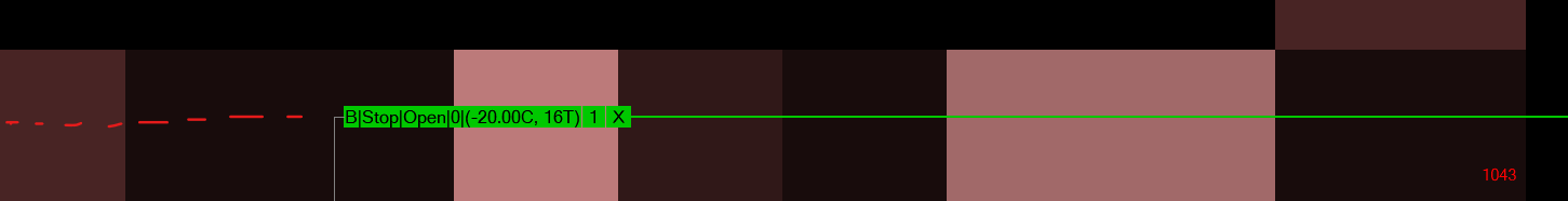

Hello
I was wondering if its possible to extend to left the lines of target/SL as in the attached.
imageScreenshot 2024-04-22 123420.png / V - Attached On 2024-04-22 09:36:46 UTC - Size: 4.88 KB - 191 views
[2024-04-22 15:41:27]
Refer to the following setting and the two below it:
Chart Settings: Align Order Cancel (X) Button to Right (Chart >> Chart Settings >> Trading menu)
[2024-04-22 16:09:38]
VLiviu - Posts: 223
So, in order to extend those lines to left, do I need to align everything to right?
-Align Order Cancel (X) Button to Right
-Align Trade Drawings Text to Right
-Trade Drawing Left Align % - 100
Am I right?
[2024-04-22 16:24:07]
Just the opposite.
If you want the (x) button to not be on the right, but to be next to wherever the order line is located, then set "Align Order Cancel (x) Button to Right" to be "No".
If you want the Order and Position lines to not be connected to the right side, then set the "Align Trade Drawings Text to Right" to be "No".
Then you set the "Trade Drawings Left Align %" to be some value between 0 and 100 in order to set the position of the Position and Order lines between the right and left sides.

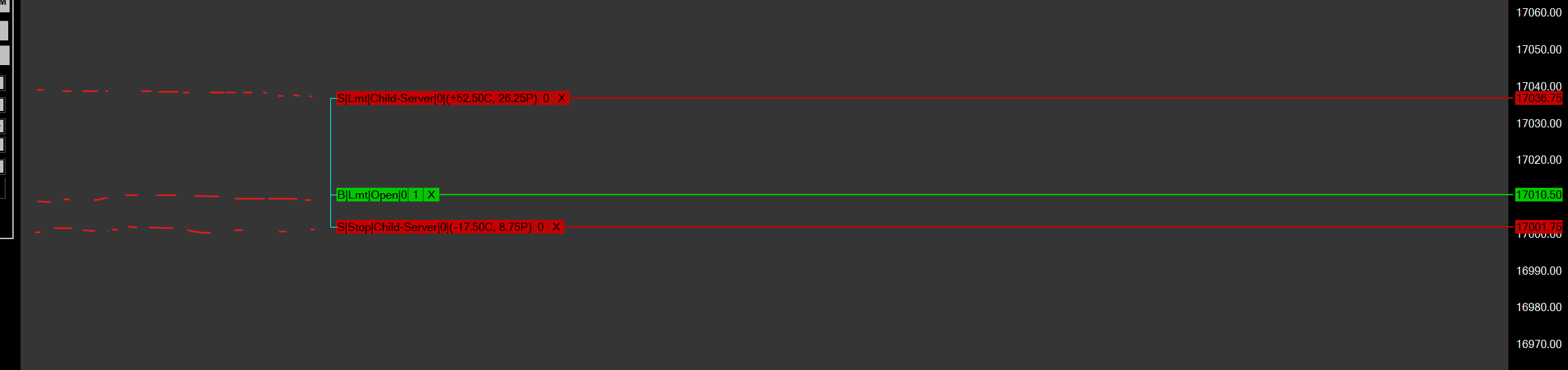

[2024-04-22 16:41:49]
VLiviu - Posts: 223
I wish I can have everything left aligned but the lines to be extended to left too, behind the labels
[2024-04-22 17:02:43]
VLiviu - Posts: 223
Please see attached, this is what I meant
imagepic.png / V - Attached On 2024-04-22 17:02:26 UTC - Size: 23.53 KB - 185 views
[2024-04-22 19:26:07]
We do not have an option to display the orders like that.
You can get a line displayed for your Position. We have put together a Study Collection that does this. Note that if you are not using the standard Green/Red colors for Profit/Loss then you will have to change the colors accordingly.
Refer to the following for how to use a Study Collection provided by Support:
Study Collections: Using a Study Collection Provided by Sierra Chart Support
attachmentPositionLineAcrossChart.StdyCollct - Attached On 2024-04-22 19:26:04 UTC - Size: 48.46 KB - 414 views
