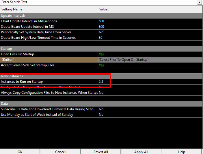

they are subinstances of the main instance. Attached is my setup.

John - SC Support - Posts: 48587
In this case, you do not need to set any specific service for these sub-instances, as the sub-instances are tied to the main instance from which they are started and use whatever trading service is setup in that main instance.
You do need to update the symbols in each sub-instance if you had to change them in the main instance. So for each instance you have running, you would select "Edit >> Translate Symbols to Current Service". Start with the Main Instance and then do each sub-instance.
Exiting from each sub-instance and restarting will not do anything for the symbols. You have to update each instance.
With regards to sub-instance #3 not running, we would need more information. You do have sub-instances 2 and 3 setup to start automatically when the main instance starts, so there should not be any issue with this. But let us know what is occurring.

Thaddeus Fulmer - Posts: 71
That worked. thank you
