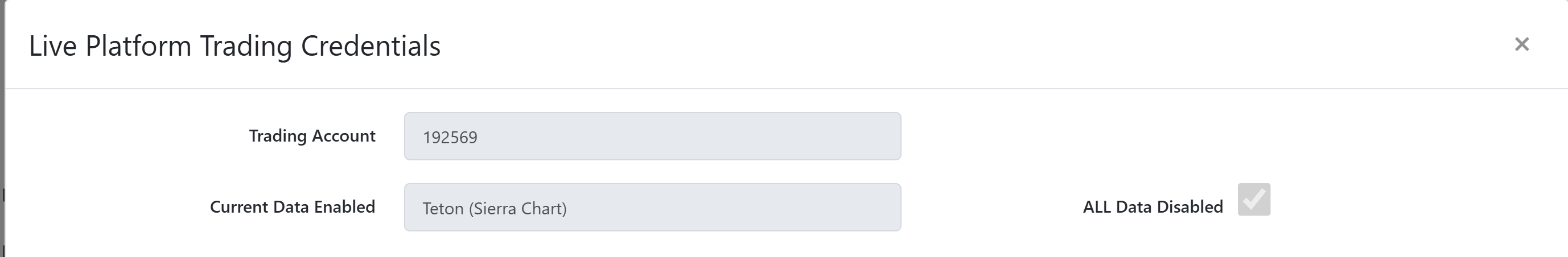

Hello Sierra Support,
I am connected through AMP Futures using Teton CME Routing. My Clearing Firm is set to AMP, but I am unable to see the username/password fields in the Data/Trade Service Settings. The connection shows “Not Connected” and no live data is coming through.
- Sierra Account Name: antwill007
- Data Feed: Teton (Sierra Chart)
- Issue: Missing login fields for live credentials, cannot complete setup.
Screenshots attached.
Please Advise,
Anthony Williams
imageScreenshot 2025-09-15 144850.png / V - Attached On 2025-09-15 18:49:04 UTC - Size: 47.1 KB - 252 views
[2025-09-15 19:13:52]
There are no credentials to enter for the Teton Order Routing service. Follow the instructions starting at Step #6 at the following link:
Sierra Chart Teton Futures Order Routing: Setup Instructions
