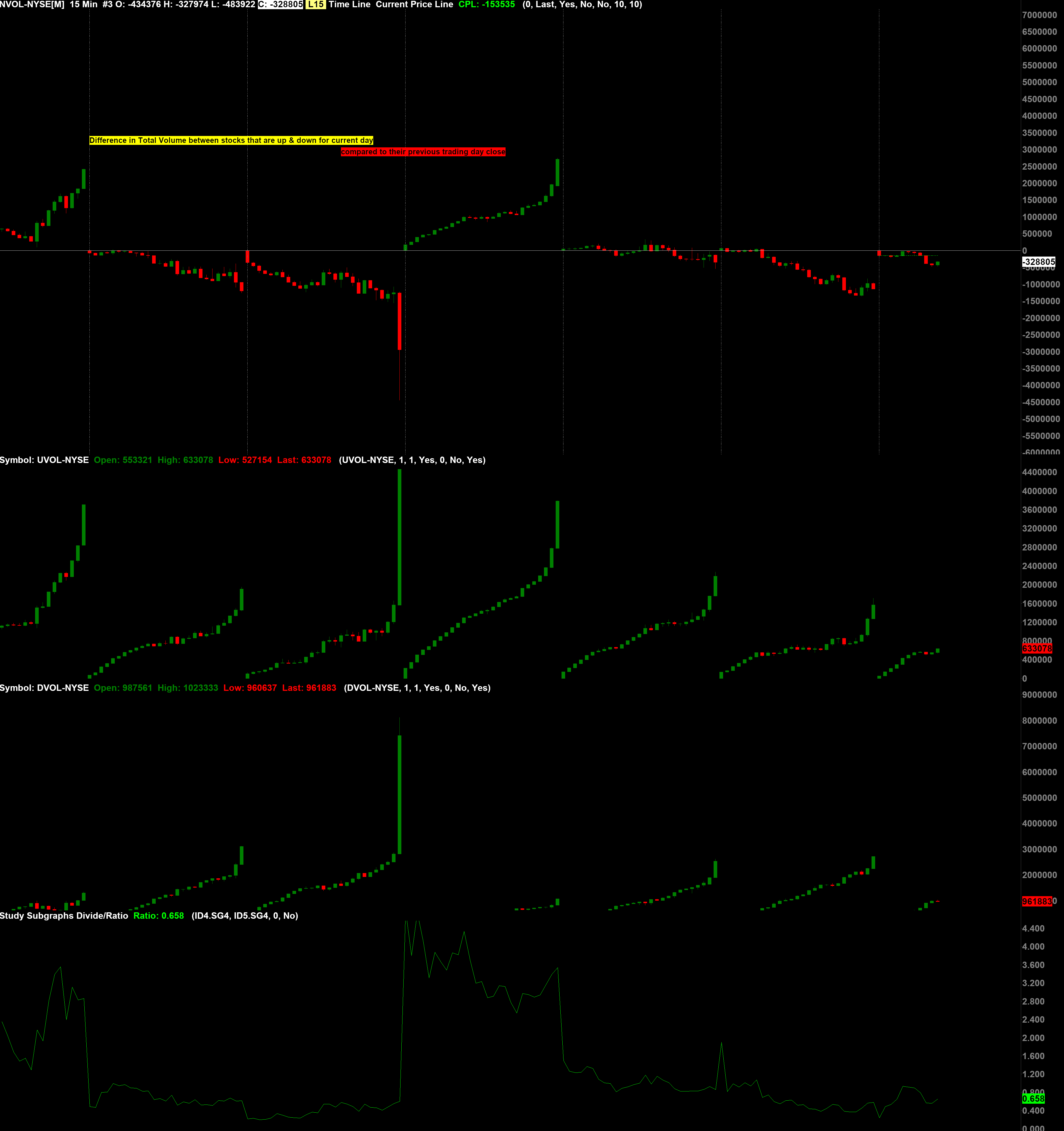

SO using the Ratio-Bar or the Spreadsheet Formula Bar I'm able to get uVol/Dvol. What I'm looking to get if its its below 0, convert .827 (Uvol/Dvol) to -1.20 and then I I guess I would be able to use the Study Subgraph Reference so color based on + or -ve value to display the text on the chart
I want to be able to add Market Breadth Text on my chart for NYSE and NASDAQ color coded as -1.20:1 NYSE or 2.48:1 NASDAQ
I know you had some other threads where you mentioned it but I was not able to get the study you mentioned Spreadsheet bar and use formula = If(C < 0, -1/C, C) to work. I was able to get it to work in the UDVR-NYSE but that's 24 hours volume
[2025-03-27 16:02:07]
Do you mean if the value is below 1 (you state "below 0") then you want to invert and multiply by -1?
And are you just wanting to do this on the Close of the bars?
[2025-03-27 16:11:40]
ameetmedi - Posts: 52
Yes, sorry below 1. I'm not 100% sure if I just need closing calculation, maybe you can point me to it. Attached is my screen shot from the Ratio I have calculated. I have the main Symbol as NVOL-NYSE. I also have added additional symbols UVOL and DVOL. and added Subgraph ratio/divide study. As you can see the volume is -ve and ratio is below 1. Taking inverse of this would be yield the -1.58. I'm trying to get to a point where I can either See the this value 1.58 in a Red Box showing -ve volume or a Green box value for a +ve volume.

We see you used the "Study Subgraphs Divide/Ratio", so that gives you a single value. In this case, to change that value to the negative inverse when it is below zero, use the "Spreadsheet Formula" study and enter the following formula:
=IF(ID1.SG1 < 1.0, -1/ID1.SG1, ID1.SG1)
Where ID1 is the ID of the Study Subgraphs Divide/Ratio study and SG1 is the Ratio Subgraph of the Study Subgraphs Divide study.
There is not a way to display a large text item that is colored red for negative and green for positive, as the "Text Display for Study" uses a drawing tool in the end to draw the information to the screen and this does not have the ability to select colors based on value. You can modify the study itself to get what you want if you are comfortable with this. Refer to the following:
Thanks so much. That gets me where I'm able to use the Spreadsheet formula to display the value in the +/- Auto coloring and serves my purpose for a glance view.
