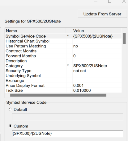

I would like to create a custom symbol = SPX500 index / US 2yr bond.
My calculations were {SPX500}/{2USNote}
but I got a blank chart.

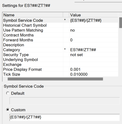

So I tried using the futures data.
My calculations were {ES?##}/{ZT?##}
However, I still got a blank chart.
I have attached the detailed settings used.
Can advise?
imageSPX 2USnote settings.png / V - Attached On 2024-04-07 08:42:23 UTC - Size: 55.87 KB - 267 views
imageES ZT settings.png / V - Attached On 2024-04-07 08:42:31 UTC - Size: 49.68 KB - 192 views

[2024-04-09 18:44:07]
First of all, you can not use ES?## (or symbols with character replacements) for a Custom Calculated Symbol. You have to enter the specific contract such as ESM24. And what symbol you use depends on what service you are connected to. So whatever symbol you use for a standard chart you would use for the Custom Calculated Symbol.

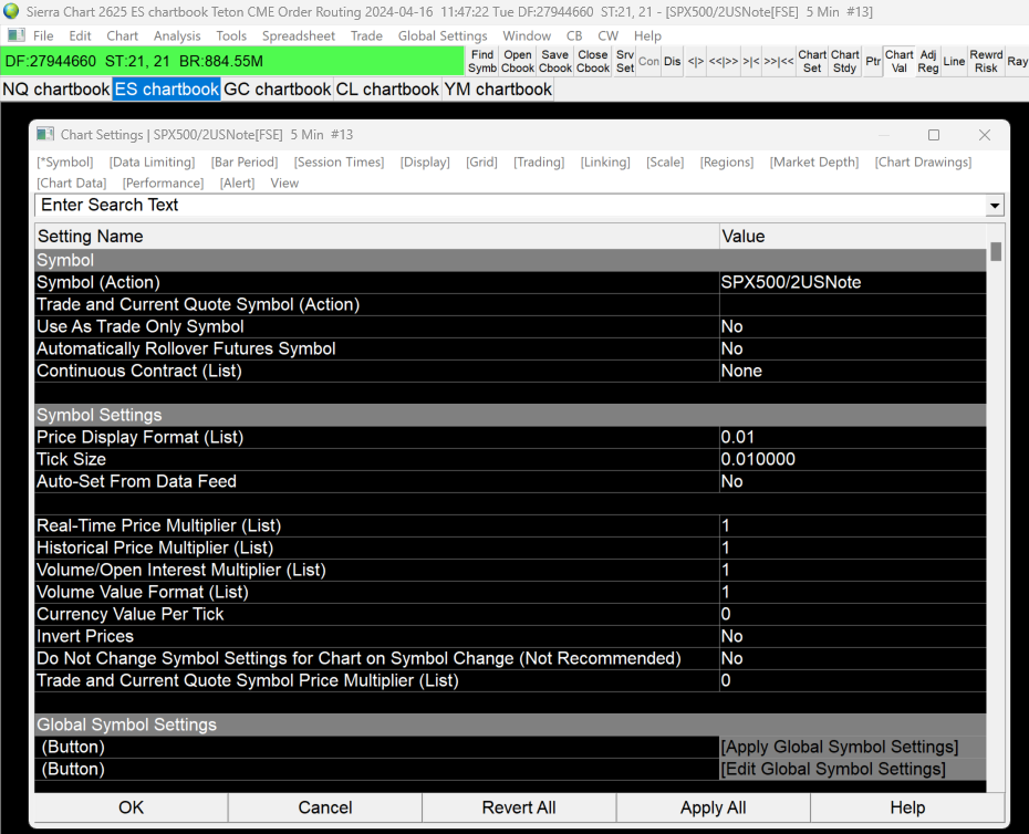

Here, I attached the "chart settings"
imagespx us2 error screen.png / V - Attached On 2024-04-16 15:52:49 UTC - Size: 182.38 KB - 254 views
[2024-04-16 17:05:57]
You are not creating the symbol correctly. We did not notice this before. You have to enter the symbol name as the formula you want. For instance, when you select "New Symbol" you would enter the following in the box that comes up to enter the Symbol Name:
{SPX500}/{2USNote}
Then do not enter anything for the "Symbol Service Code".
