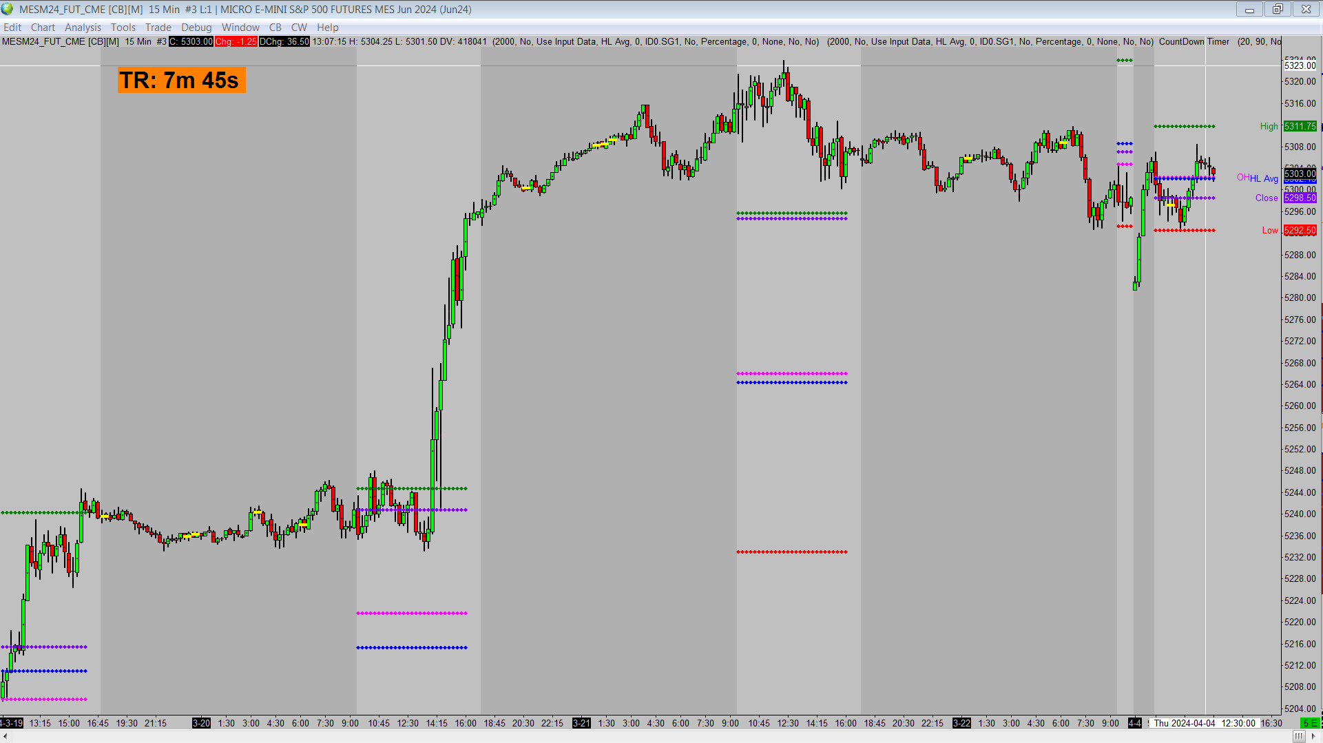

The problem is the only data being displayed on my Intraday charts is 4/3/20, 4/3/21, 4/3/22 and then 4/4/24.
I am on the June contract using Version 2626. Date range for charts is 2024-02-25 to 2024-04-04.
I have performed the steps to correct for incomplete/missing data at earlier dates in continuous futures contract charts with no change.

jbech96 - Posts: 39
I have uploaded (attached) a copy of my Intraday chart displaying the issue I am having. I had to do it this way because I do not have a web browser on my trading computer.
imageSierra Intraday Chart 2024.PNG / V - Attached On 2024-04-04 17:12:05 UTC - Size: 137.65 KB - 262 views

[2024-04-04 21:58:56]
John - SC Support - Posts: 48587
Please redo the instructions at the link given in Post #4 starting at Step #7, which states to select "Edit >> Delete All Data And Download". When you do this, you will get a pop-up that shows the different contracts. Select at least the most 2 recent contracts to re-download the data. This is necessary in order to ensure that you are redownloading the missing data in any contract that may have have the data you need.
[2024-04-04 22:20:28]
jbech96 - Posts: 39
The mistake I made the first time when I made the selection in the "Multiple Symbol Selection Window" was to also enable "Download for Daily Data Files Only". I did not do that this time and my charts are now loaded correctly. Thank you John for your assistance.
