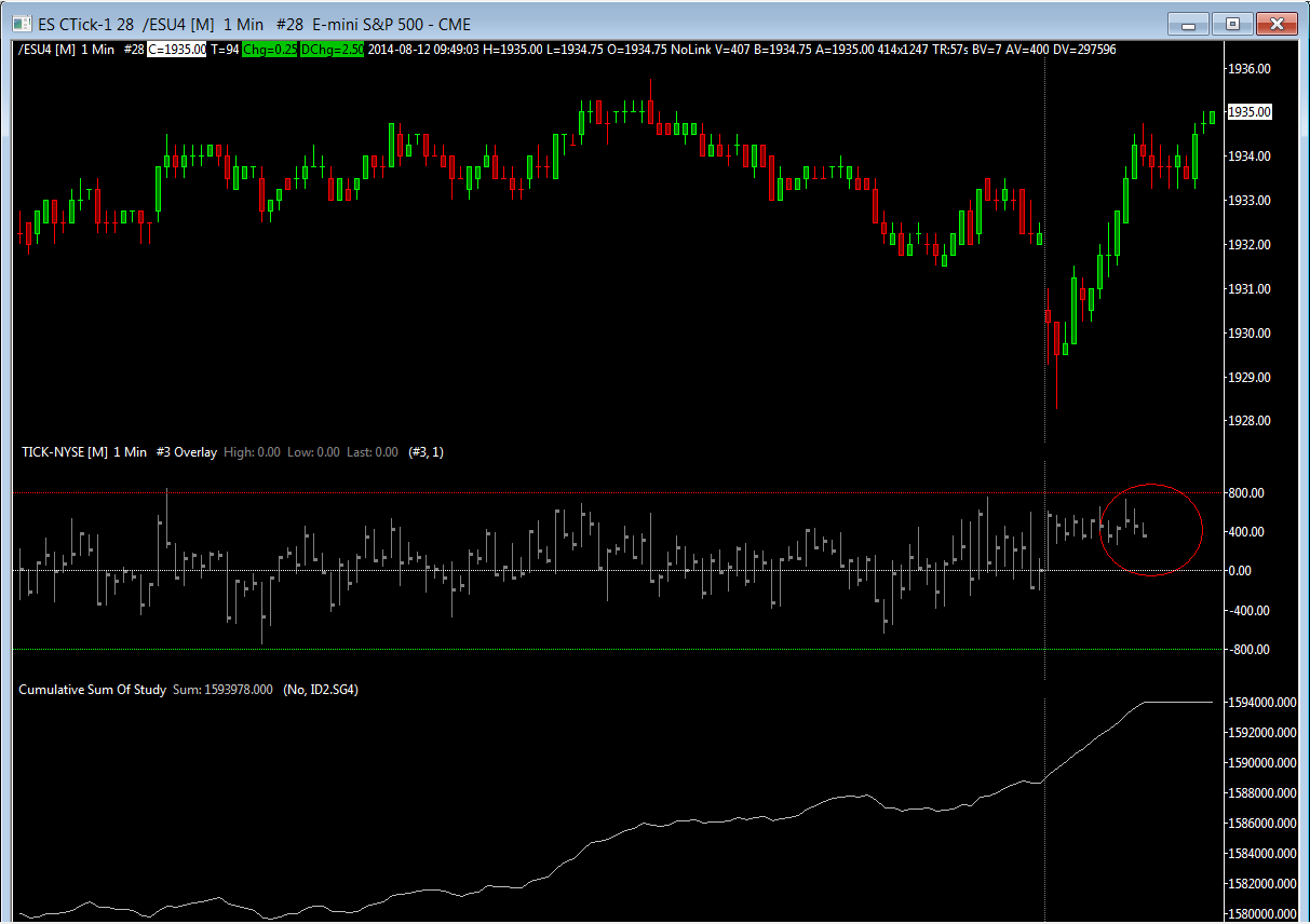

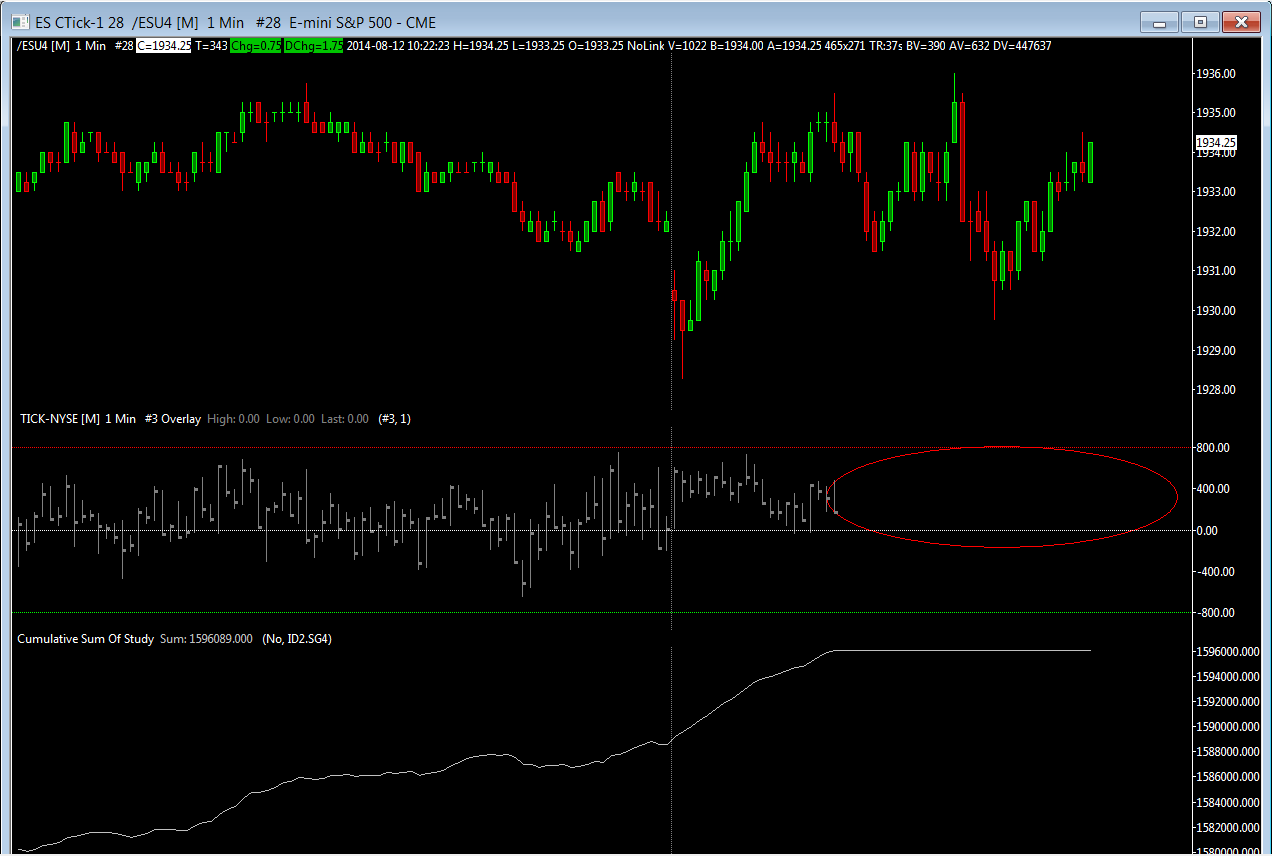

Hi, I sent you a log a few minutes ago. It happens on intra day charts. Please see attached to see spots where it stops for a few minutes , then starts again.

imagetick_2.png / V - Attached On 2014-08-12 14:27:41 UTC - Size: 44.75 KB - 451 views
imagetick_3.png / V - Attached On 2014-08-12 14:27:55 UTC - Size: 45.66 KB - 431 views

There is no data feed connection problem based upon the Message Log. There must be some other issue. You are overlaying that chart from another chart which adds to the complexity of the issue. When presenting a chart updating issue to us, you need to simplify the problem by showing the original chart.
Look at the original chart and refer to help topic 3 to determine what the problem is:
Http://www.sierrachart.com/index.php?page=doc/helpdetails3.html
Your Sierra Chart Message Log is full of ongoing messages like these:
Chart #28 is performing a full recalculation because it has been tagged. Chartbook: ES vzones.cht | 2014-08-12 10:24:30
Chart #3 has tagged chart #2 for full recalculation. Chartbook: ES vzones.cht | 2014-08-12 10:24:34
Chart #3 has tagged chart #26 for full recalculation. Chartbook: ES vzones.cht | 2014-08-12 10:24:34
Chart #3 has tagged chart #28 for full recalculation. Chartbook: ES vzones.cht | 2014-08-12 10:24:34
Chart #26 is performing a full recalculation because it has been tagged. Chartbook: ES vzones.cht | 2014-08-12 10:24:34
Chart Settings have been synchronized between Destination chart number #26 and Source data chart number #3. Performing a chart reload of source data chart. | 2014-08-12 10:24:34
You have a chart which is continuously reloading. Refer to help topic 30.3 here:
https://www.sierrachart.com/index.php?page=doc/helpdetails30.html#h30.3
