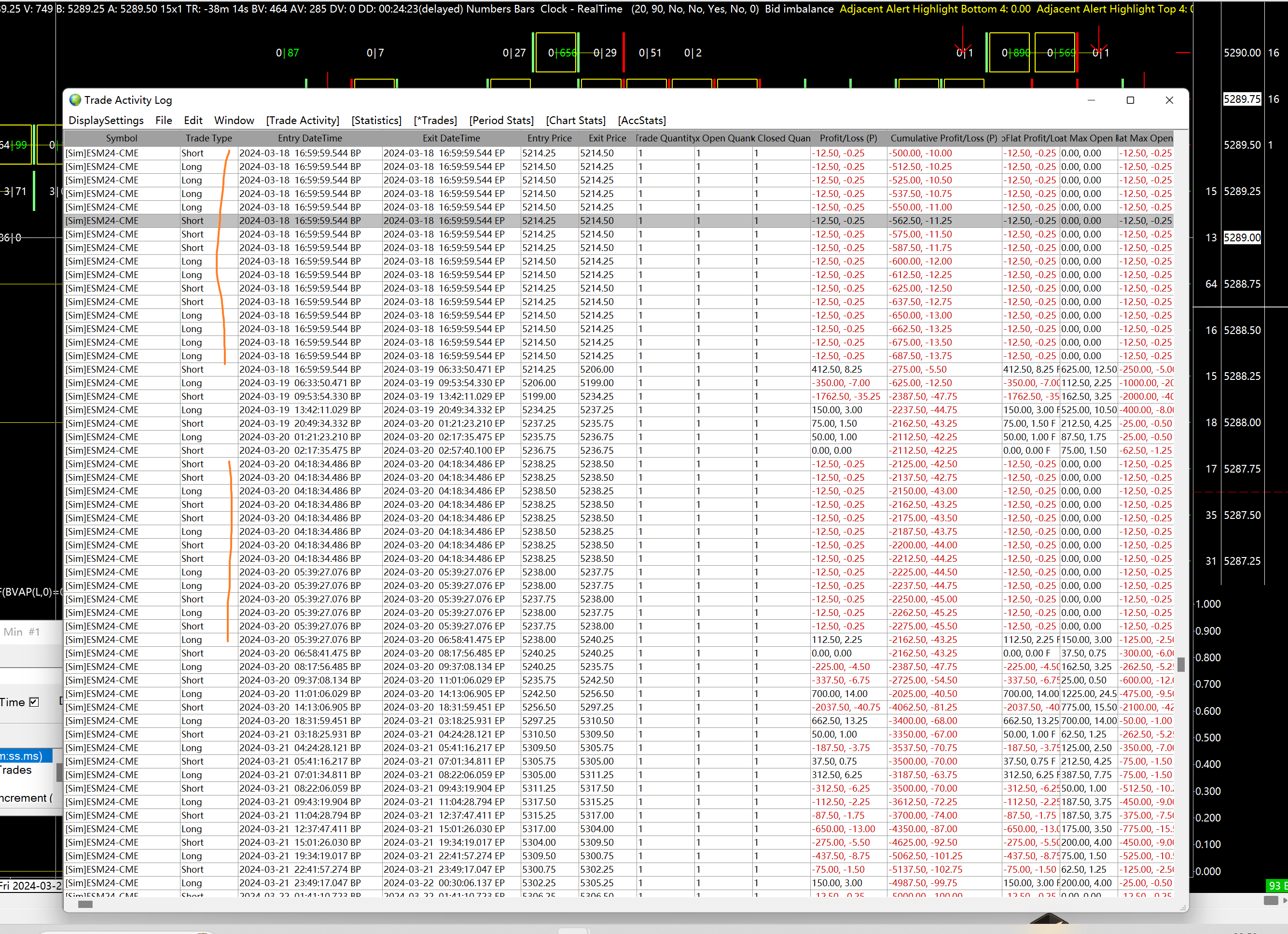

I create a spreadsheet system,just practise. As you can see in attachment, why so many trades entry on same time?
It looks very abnormal.
2. OR(AND($J$8 > 0, ID0.SG4@$3 0, ID0.SG4@$3 >= $J$9+2, is $ necessary be added?
imageTrades on same time.png / V - Attached On 2024-03-25 17:28:33 UTC - Size: 385.34 KB - 191 views
attachmentTradesList.txt - Attached On 2024-03-25 17:28:40 UTC - Size: 27.89 KB - 402 views
Probably because:
- Signal Only On Bar Close is set to No
- Signal Only Once Per Bar is set to No
- Several other possibilities

I tried set Signal Only On Bar Close yes or no,set Signal Only Once Per Bar yes or no.
But there are still too many trades that occur at the same time and are all exit on 1 tick stop-loss.
How do I need to export my testing spreadsheet strategy to you to make it easier for you to find the bug?

I am sure there is no multiple entry in same bar if i choose "Accurate TradingSystem Back Test Mode", My fault because i choosed "Standard Replay" last time.
