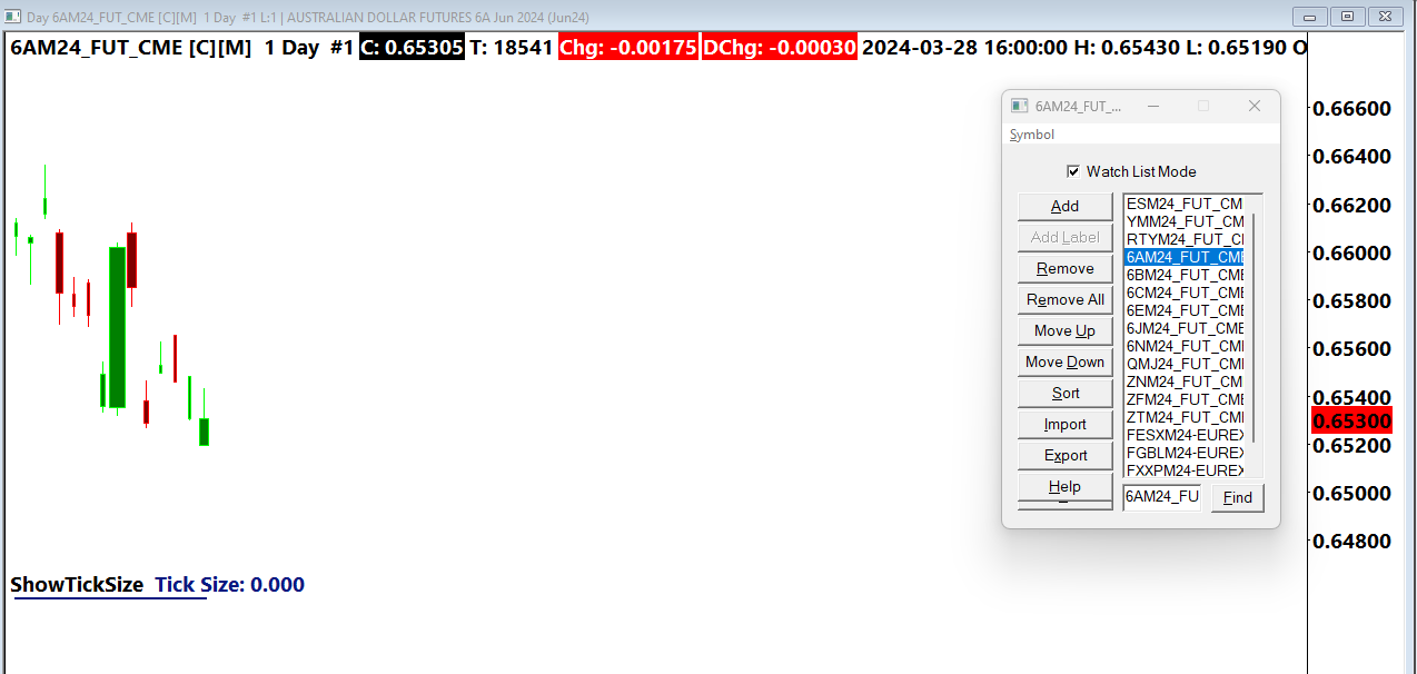

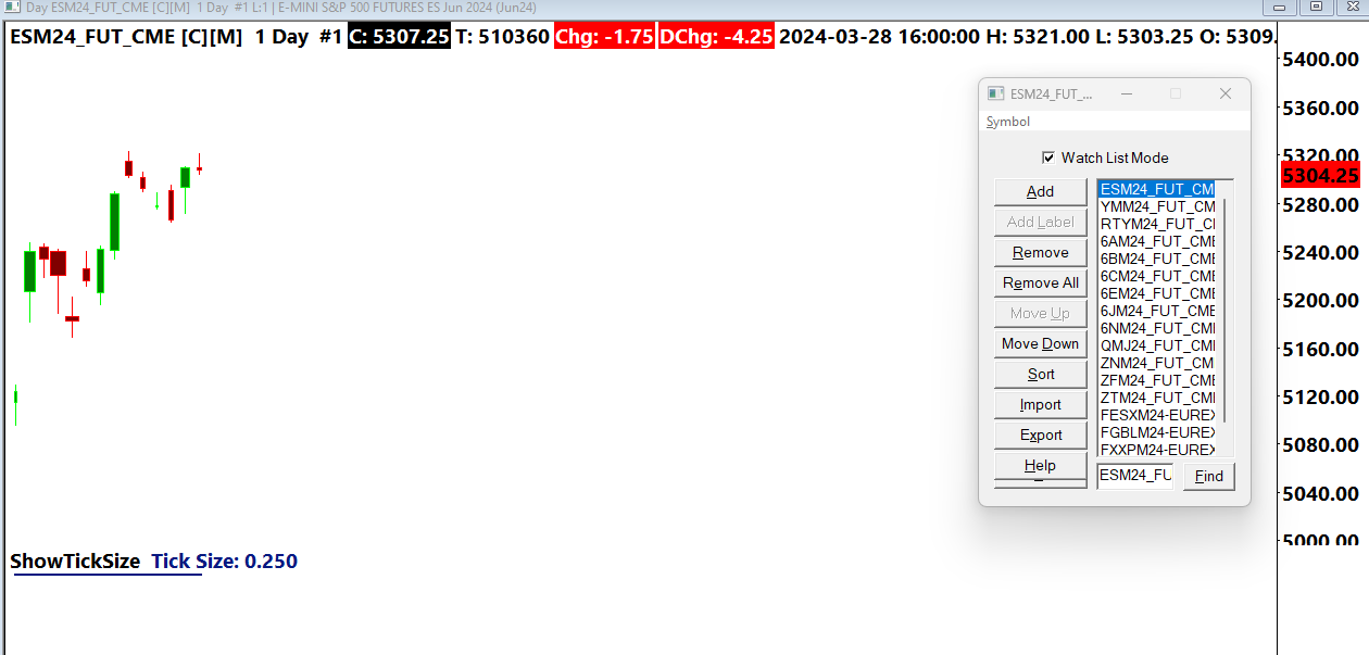

When running this study as in my primary study, I noticed that sc.TickSize is 0 sometimes and sometimes it returns the actual ticksize.
I checked the message logs and received an error stating that there was a CPU exception and the study made the platform unstable until removing it and restarting the platform.
I believe this explains why sc.TickSize was 0 in the prior posts.
I've attached examples of running this simple study via a scan which shows sometimes the return value is correct and sometimes it is 0.
