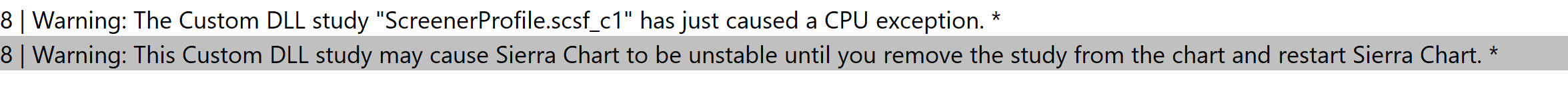

When running this study as in my primary study, I noticed that sc.TickSize is 0 sometimes and sometimes it returns the actual ticksize.
I checked the message logs and received an error stating that there was a CPU exception and the study made the platform unstable until removing it and restarting the platform.
I believe this explains why sc.TickSize was 0 in the prior posts.
I've attached examples of running this simple study via a scan which shows sometimes the return value is correct and sometimes it is 0.
Ideally, removing the study and restarting the platform should correct this per the message logs.
imageTickSize Exception.png / V - Attached On 2024-03-29 03:20:35 UTC - Size: 20.28 KB - 279 views
