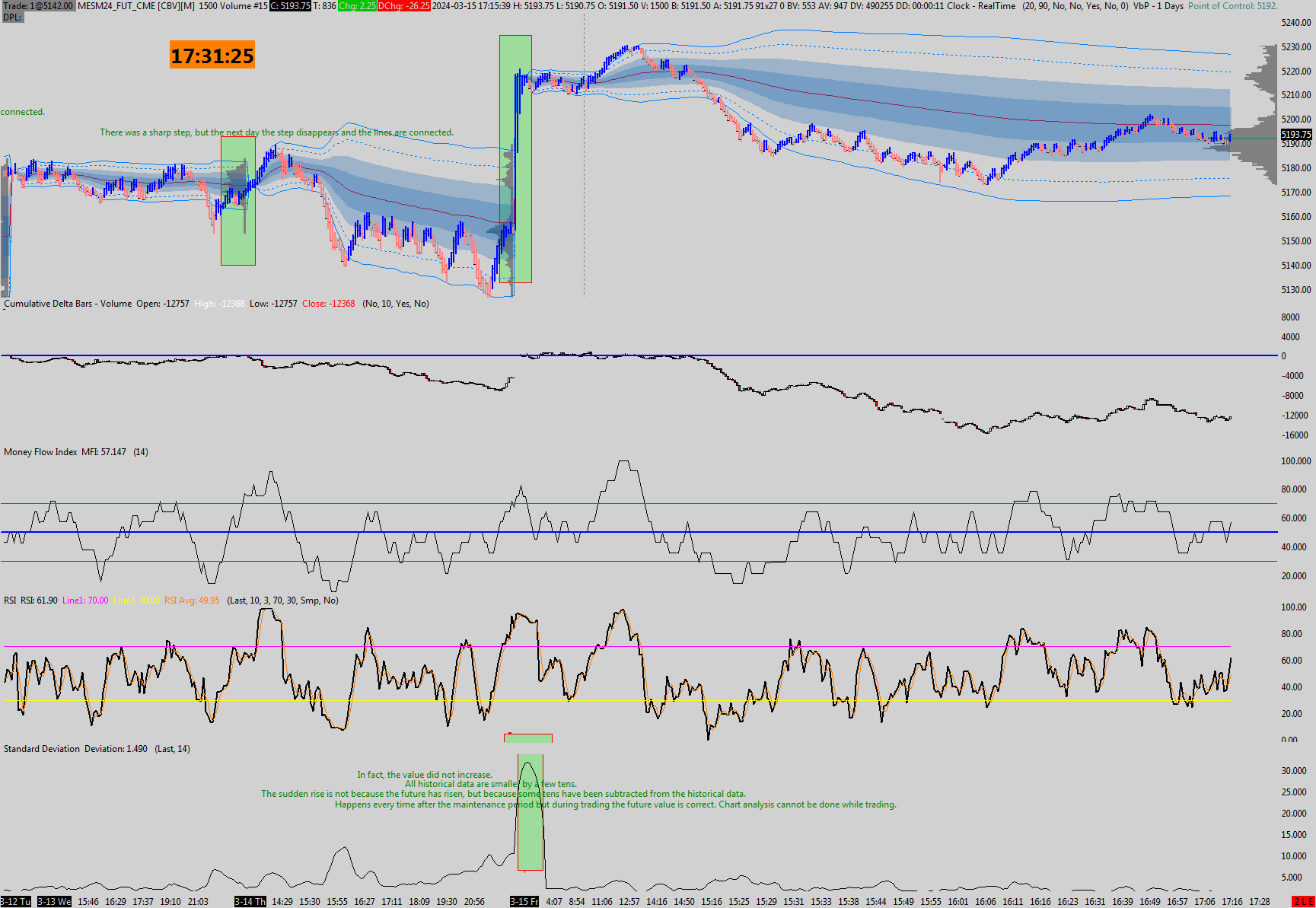

Historical data is not correct. I dont know what is wrong. The sudden rise is not because the future has risen, but because some tens have been subtracted from the historical data after the maintenance period. Not every future has this kind of problem. Grude Oil and Gold are correct. Happens every time after the maintenance period but during trading the future value is correct. Chart analysis difficult to do while trading because the trading lines are not connected to the previous trading day. Later the lines will be connected, but it would be necessary for the lines to be connected immediately. The standard deviation indicates a false signal because of this.

Refer to the following:
Continuous Futures Contract Charts: Basic Steps to Correct Invalid Back Adjust Amount for Most Recent Transition to New Contract Month
