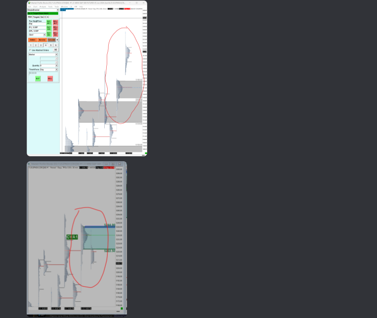

My market profil data seem to be not correct, when compare to the ones of other persons that are trading the same market as me with the same contrat. In the attachement below, you will see two picture the one above is my market profil and the one under is the correct one. In my market profil chart the profile of today is above the one from yesterday, but in the correct one the profile of today should be below the one from yesterday

The images are of such low quality that we can not read the information in the Chart Header to determine how these charts are setup.
Most likely this is due either not using a Continuous Futures Contract, or due to using a different Continuous Futures Contract option from the one you compare to. In either case, refer to the information at the following link:
Continuous Futures Contract Charts
