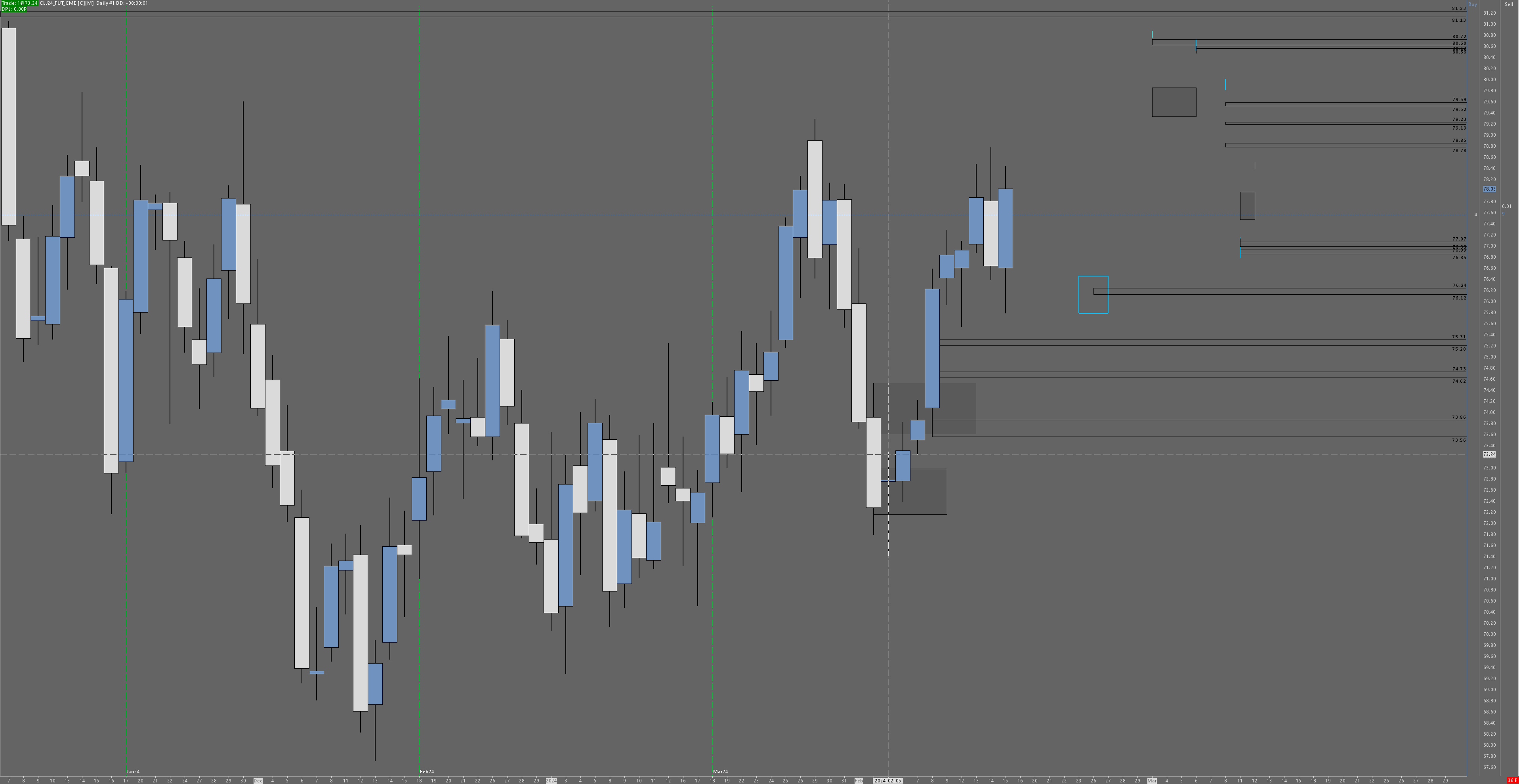

[2024-03-12 17:53:10]
cuckiecheese - Posts: 119
https://www.sierrachart.com/image.php?Image=1710265885341.png
you can see by the price line where price actually is
https://www.sierrachart.com/image.php?Image=1710265926854.png
here i've scrolled the chart over a bit and you can see price shown correctly

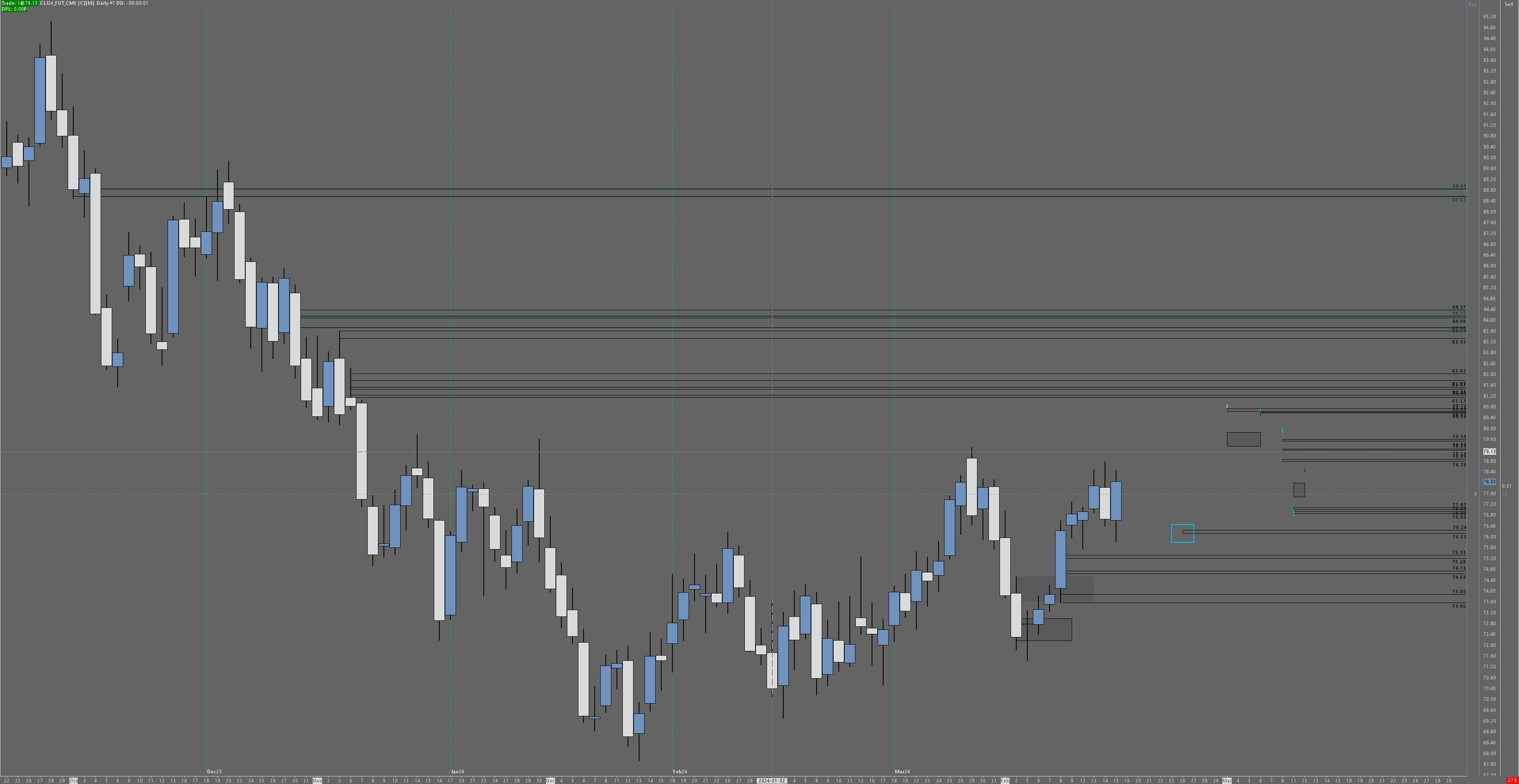

[2024-03-12 18:14:04]
https://www.sierrachart.com/image.php?Image=1710266898243.png
https://www.sierrachart.com/image.php?Image=1710266928500.png
https://www.sierrachart.com/image.php?Image=1710267003753.png
another example, i'm tabbing between charts and when i get to a chart sometimes it looks like the first screenshot. the second screenshot shows what happens if i scroll the mouse wheel (which is zoom for me), nothing happens. the third screenshot shows if i move the chart (using hand tool), it gets fixed
[2024-03-12 19:34:26]
We are a bit confused, as your indicator in the lower right shows that you do not have "Lock Fill Space" enabled, but it also indicates that you are not scrolled to the end of the chart. So these two things seem to be conflicting.
Can you please get us a chart that shows this and give us the exact workflow of what you are doing that shows this occurring. Hopefully we will be able to reproduce it and figure out what is happening. Refer to the following for how to get us a chart:
We would also like for you to try this with a new chart and do what you do and see if it happens with a new chart.

[2024-03-12 20:02:56]
We can tell you how to fix it, but we are not sure why it is happening.
It is related to the Linking of the charts for the "Scroll Position". When the higher time frame chart is scrolled off the end of the window and then back, then there is a "fake" lock fill space created on the lower time frame chart.
We were able to reproduce it with our own chart, so it is not something specific to you, just to the particular way you are using the option.
The solution is to remove the linking for "Scroll Position" from both charts.
We do not know when we will be able to dig into this deeper.
