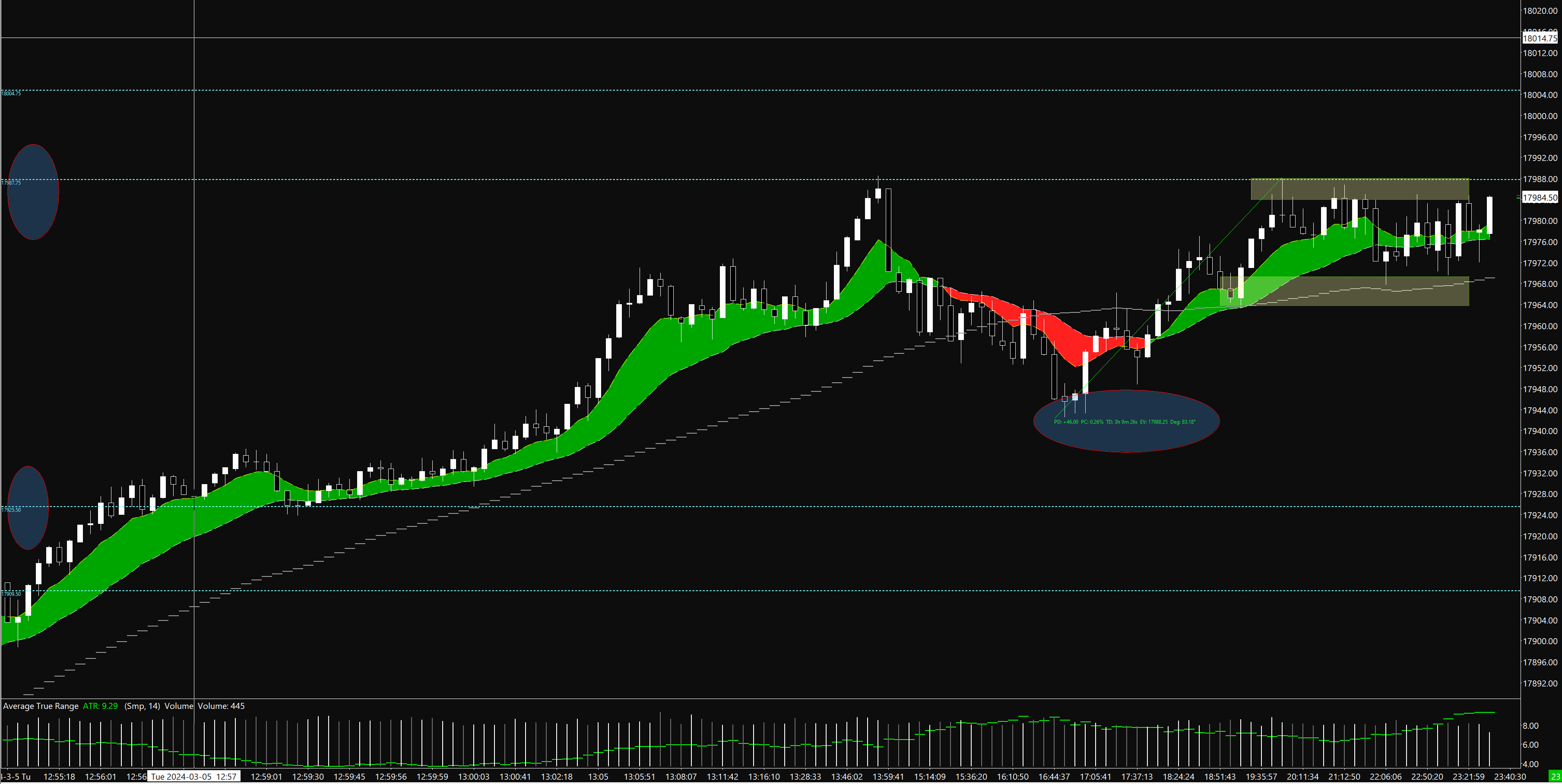

This is a problem i should know how to fix but for some reason my Font on my drawing tools got to small for me to read and i have not been able to fix it. I do not know how this changed or why....
In the ecliptics you can se the writing is so small.. it is like this on all my drawing tools
How can I for this
thanks
imageSierra capture.PNG / V - Attached On 2024-03-06 07:49:32 UTC - Size: 185 KB - 165 views
[2024-03-06 17:51:10]
This can happen when running an older version of Sierra Chart after going back to an earlier version from a newer version of Sierra Chart.
You need to adjust the font sizes for Chart Drawings:
Chart Drawing Tools: Changing the Font Size For Text Displayed with Tool Drawings (Global Chart Drawing Font)
