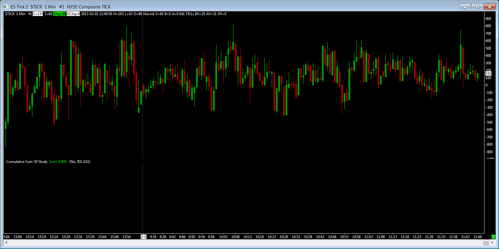

[2014-08-07 18:26:55]
User28682 - Posts: 233
Thanks, that study makes sense. I inserted $TICK in top pane, cumulative tick below it. I have "no" for reset...nothing happens. The $TICK up top is not even updating. See attached.
Tom
imagecumulative_tick.png / V - Attached On 2014-08-07 18:26:22 UTC - Size: 38.16 KB - 808 views
[2014-08-07 18:32:27]
You need to use the symbols from the new Sierra Chart market statistics data feed:
Sierra Chart Market Statistics
The symbol is TICK-NYSE.
You are using the old symbol.

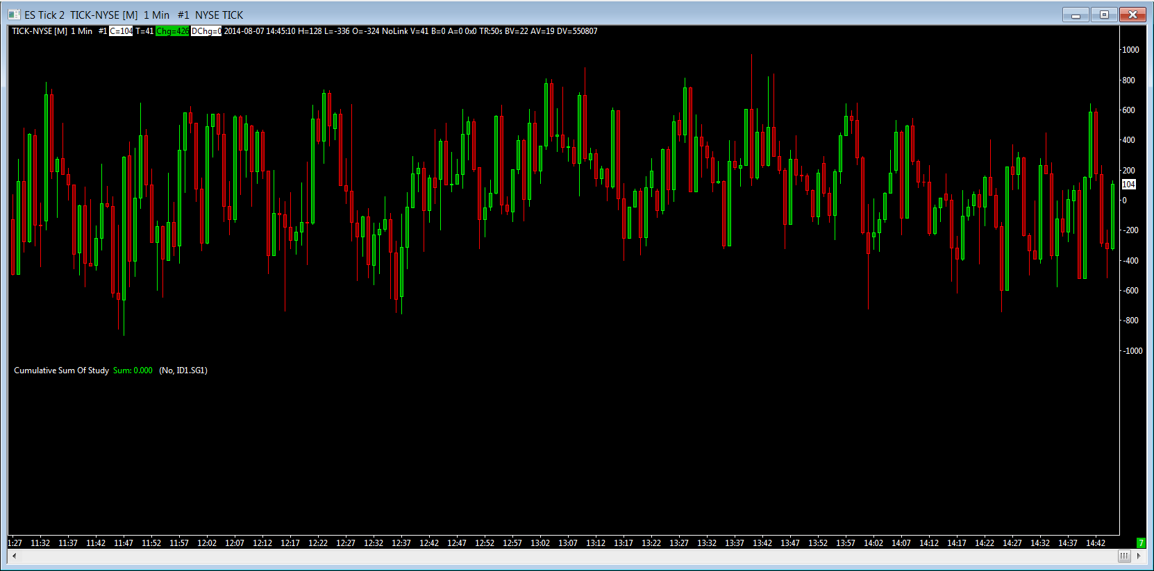

[2014-08-07 18:47:01]
Thank you again. Does this cumulative study work on an intra day chart like I have attached?
Tom
imagecumulative_tick_2.png / V - Attached On 2014-08-07 18:46:49 UTC - Size: 32.85 KB - 778 views
[2014-08-07 22:22:10]
Yes it will. Go to the Study Settings for Cumulative Sum of Study and set the Study and Subgraph to Reference study part of the input to the "Main Price Graph". And the Subgraph to Last.

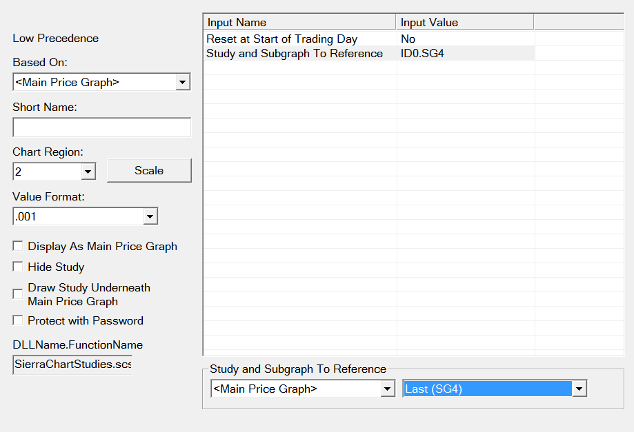

Thank you for that time and help. So, to make sure I understand this study. If I don't reset this cumulative line at the beginning of each day, and I use regular market session hours, it should be a continuous line that keeps on adding/subtracting the latest value, right? makes sense to me that way.
So, attached are my settings for this study based on TICK-NYSE, AND a chart with TICK-NYSE on top and
Cumulative Sum of Study for TICK-NYSE below it. I am looking at a daily chart for the last 3 days. On my chart, today is point "C", yesterday is "B", and the day before yesterday is "A". The change in closing TICK-NYSE from point "A" to "B" was approximately 373 pts (A = -144, B = 229, so -144 to 229 = 373pts). Your Cumulative study should then add 373 pts to its previous total to get a new total, right? Its total at "A" in the lower chart is 12,121, add 373 and get 12,494. But, the value at point "B" is actually
12,352. Something doesn't add up here. The difference from yesterday "B" to today "C" in closing NYSE-TICK is -367pts, almost the same as the change the day before. Subtract 367 from 12,352 (12,352 - 367= 11,985). Your actual value for today in the lower chart is 12,215 "C" in the lower cumulative chart.
What am I missing here? It should very simply add or subtract the latest change to a running cumulative line. I looked at the cumulative TICK from another source and instantly could see something wasnt adding up. Maybe I am just missing something.
Tom
imageCum_Sum_of_Study_Settings.png / V - Attached On 2014-08-08 00:02:44 UTC - Size: 29.3 KB - 854 views
[2014-08-08 17:40:24]
What is the timeframe of the chart bars that you put the study on? With the way that you want the calculations to be done, the bars need to be Daily bars, because every chart bar is included in the calculation. You cannot do this on an Intraday chart, otherwise it will not work like you want.
