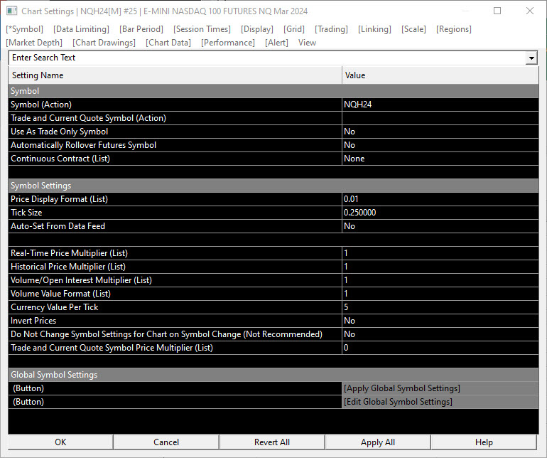

What is the setting for "Chart >> Chart Settings >> Symbol >> Currency Value per Tick" for the NQ chart?
[2024-02-29 18:06:26]
Meklon - Posts: 273
The Chart >> Chart Settings >> Symbol >> Currency Value per Tick" for the NQ chart is set to 5.
It has not changed recently or ever. Just wanted to mention once more that this problem has started to appear since yesterday after I have held a position overnight for several days and then flattened, shortly before yesterday. Yesterday before RTH I was flat and today I was flat as well for NQ on SC Trading Evaluator.
Another DOM next to this one for ES works correctly.
Date Time Of Last Edit: 2024-02-29 18:07:03
imageNQ DPL Settings.jpg / V - Attached On 2024-02-29 18:06:59 UTC - Size: 161.89 KB - 194 views
