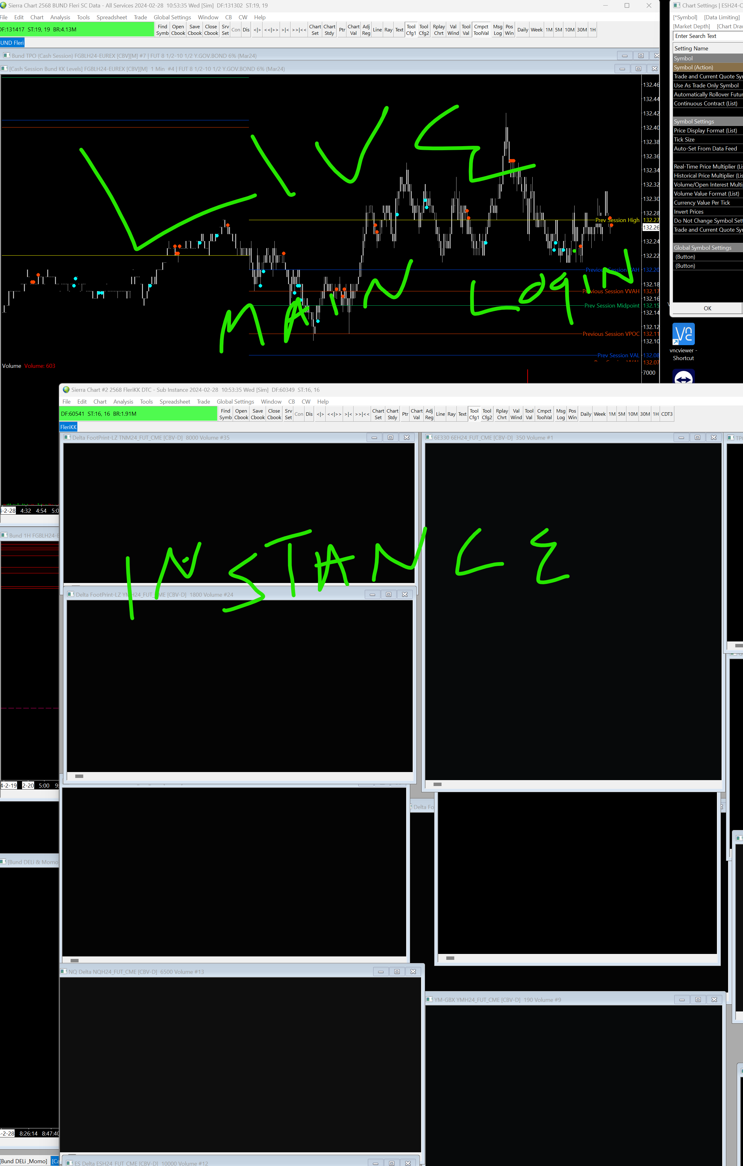

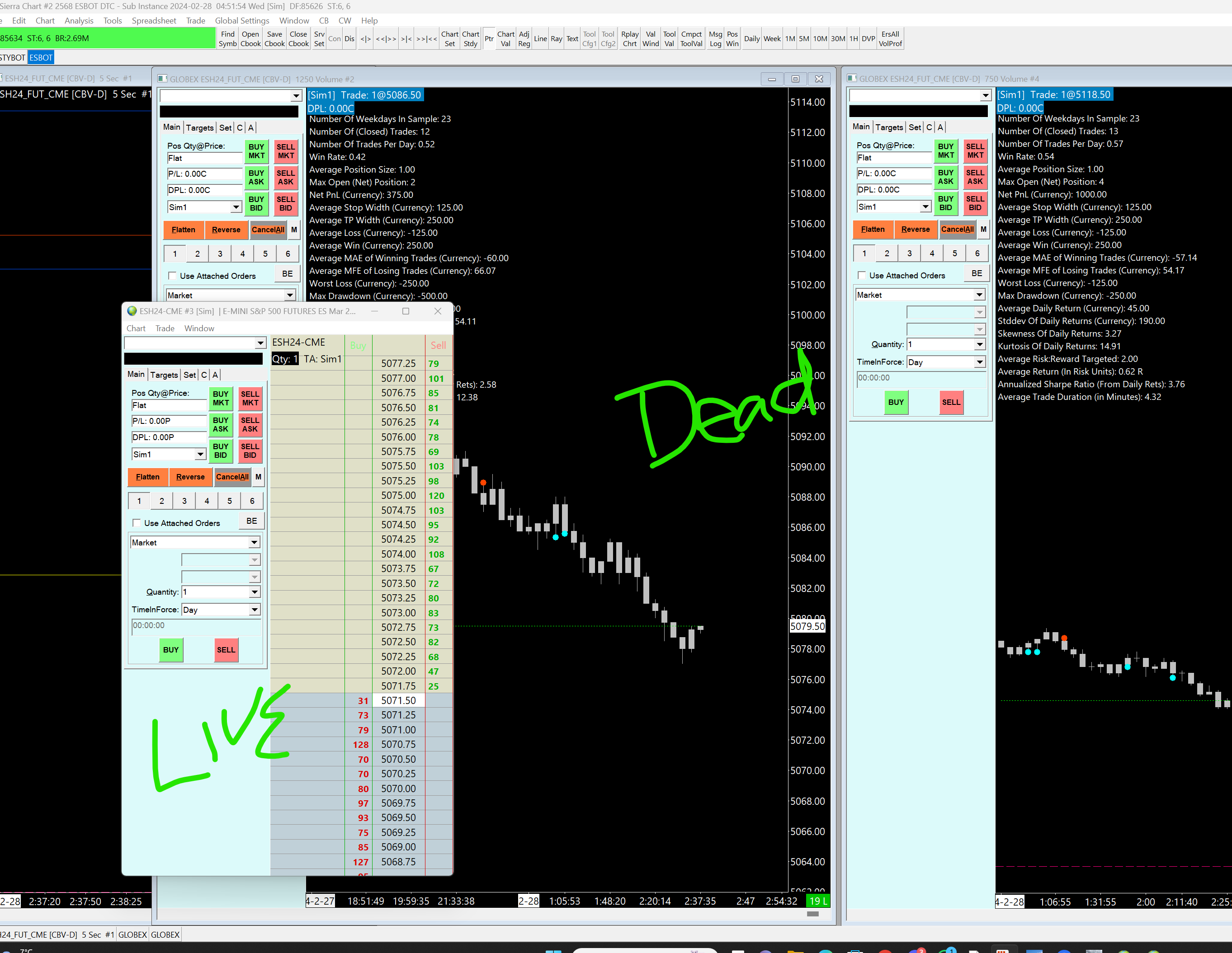

I have a big issue.-suddenly without warning none of my instances will not load data nor work. I suddenly looked over and thought What??? My main login pages in both Sierra Chart Teton and SC All Service are working perfectly, but now NO data will update in the instance's charts, BUT a dom works that I pull up in the Teton instance. Please see the example attached. I was told by Fleri in the past when my charts would seize up to go and delete all the scid files and restart. Please see the second attached screenshot of the All Service(which I deleted all the scid files) with working bund in the main log-on, and then the not loading of anything in the charts.

imageSC .png / V - Attached On 2024-02-28 10:53:10 UTC - Size: 474.58 KB - 210 views
imageSC2.png / V - Attached On 2024-02-28 10:54:44 UTC - Size: 386.85 KB - 171 views

We do not know what might have happened. Your Message Log does not show anything in particular related to any errors.
But, it does show that you have the wrong symbols for when your "Current Selected Service" is set to "SC Data - All Services". It sounds like you have that setup in a separate installation from your connection to the Teton Order Routing Service. If this is correct, then in that installation open your Chartbooks and select "Edit >> Translate Symbols to Current Service".
You should NOT delete the .scid files. If we remember correctly, you use a lot of data going back awhile with Continuous Futures Contracts. As such, if you delete the files, you will have to redownload all that data. This could easily take 30 minutes or much more.
