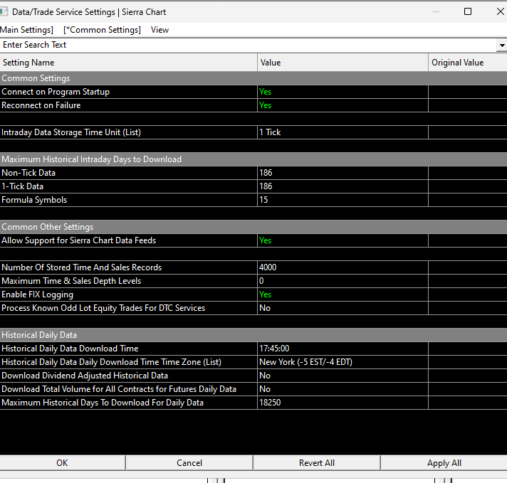

Ive been using this with one instance no problem since I commented last. However, Ive opened a new instance for the first and none of the data is loading from Binance?
The data on the ExampleChartbook page loads fine. Ive added a screenshot of the settings in case you need it.
imageScreenshot 2024-03-11 163202.png / V - Attached On 2024-03-11 16:32:33 UTC - Size: 35.86 KB - 197 views
imageScreenshot 2024-03-11 162953.png / V - Attached On 2024-03-11 16:32:39 UTC - Size: 23.73 KB - 276 views
[2024-03-11 16:54:28]

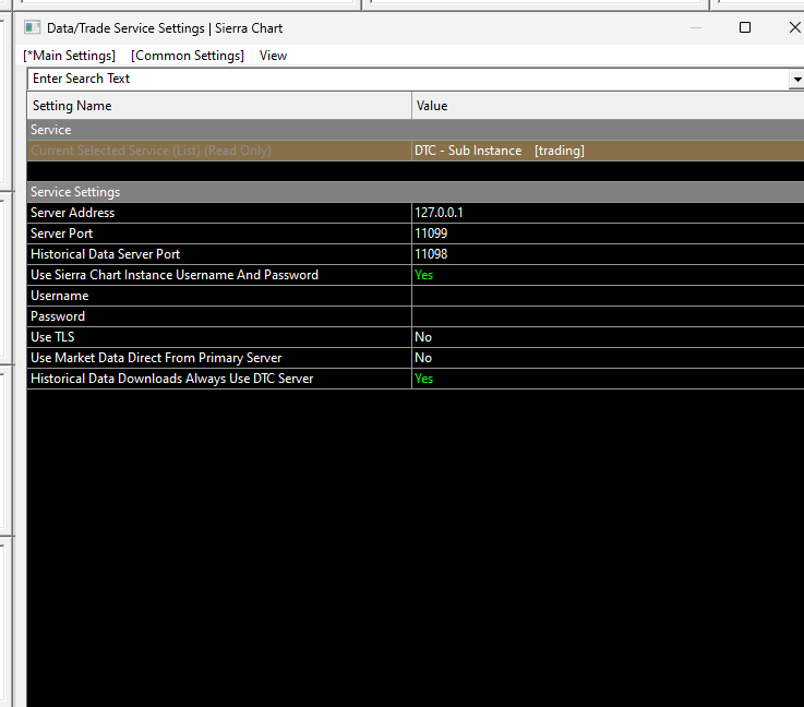

[2024-03-12 16:39:03]
StephenL - Posts: 122
Thanks for the reply.
I have Binance on a separate installation of Sierra Chart, and its working. But when I create a second Instance from the separate Sierra Chart, Binance won't work on the second instance.
I've attached the data settings for the separate Sierra Chart and the Second Instance.
imageScreenshot 2024-03-12 163517.png / V - Attached On 2024-03-12 16:35:30 UTC - Size: 34.58 KB - 201 views
[2024-03-12 17:22:14]

imageScreenshot 2024-03-12 202457.png / V - Attached On 2024-03-12 20:25:13 UTC - Size: 4.6 KB - 278 views

Now that there is data in the main instance, are you able to get it in the Sub-Instance? If not immediately, then please try "Edit >> Delete All Data and Download" and let us know.
[2024-03-13 01:03:16]
This is not going to work at all for you:
2024-03-12 20:03:43.810 | DTC - Sub Instance | Successfully connected. Connected to SC DTC Protocol server. Service=cqg|SymbolSettings=cqg.
You need a fully separate independent installation of Sierra Chart. Not a sub instance. That will not work.
You need to do what we said in post #5.
Your main instance of Sierra Chart is set to use CQG. That is not going to work.
Date Time Of Last Edit: 2024-03-13 01:03:57
[2024-03-13 09:33:50]
Ahhhhh right, I think I get you now.
I did what you said in Post #5 (and John's Post #2) and I had two sperate Main Instances of Sierra Chart running (located on separate drives on the same computer). The original CGQ data one, and a new one for SC Data.
And so even though I created a new Sub-Instance from the SC Data Main Instance (running Binance on SC Data), the new Sub Instance still links up with the original CQG Main Instance?
(I appreciate you taking the time to walk me thru this im sure its basic stuff from your pov)
[2024-03-13 15:18:27]
With regards to the Sub-Instance situation, refer to the following:
Using DTC Server for Data and Trading in Another Sierra Chart Instance: Resolving DTC Protocol Server Port Number Conflicts
