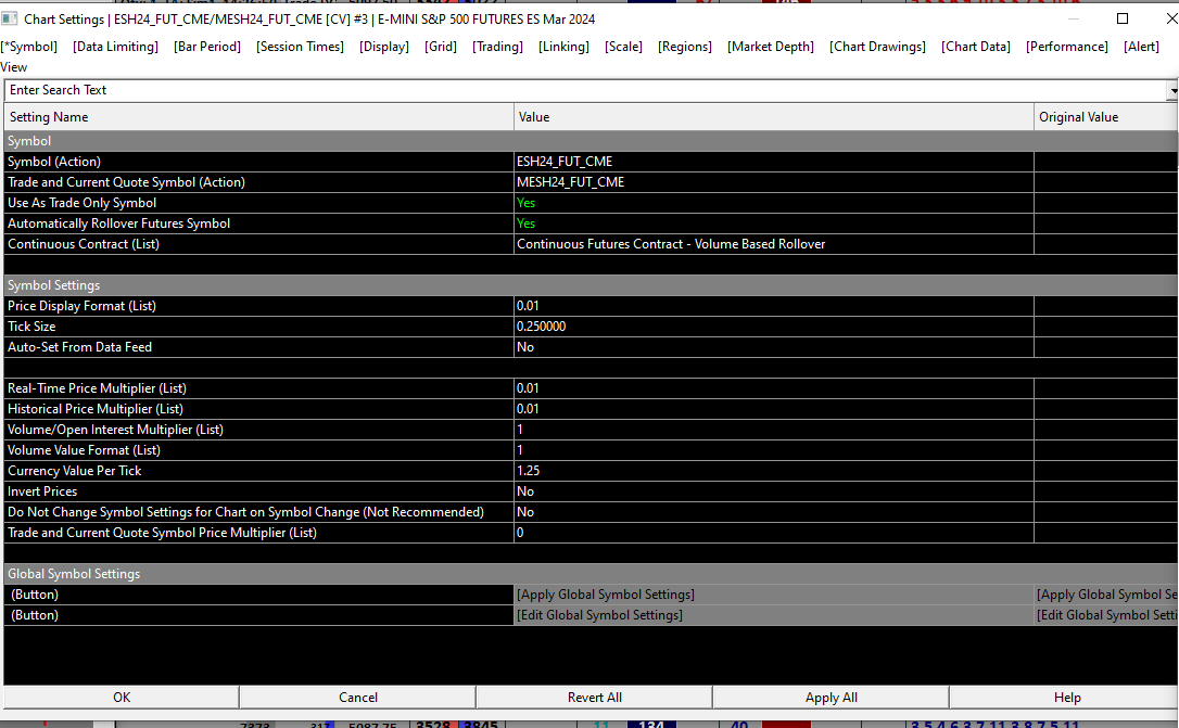

Just to verify
So you would be able to visualize the data from ES on the Trade DOM while trading the MES for example
I am attaching a screenshot of the chart settings that i am referring to see if I have this correct
Thank you

John - SC Support - Posts: 47955
The way you have it setup, you are viewing all the chart data for the ES (since you have the option for "Use as Trade Only Symbol" set to "Yes"). When you submit an order it will be for the MES.
