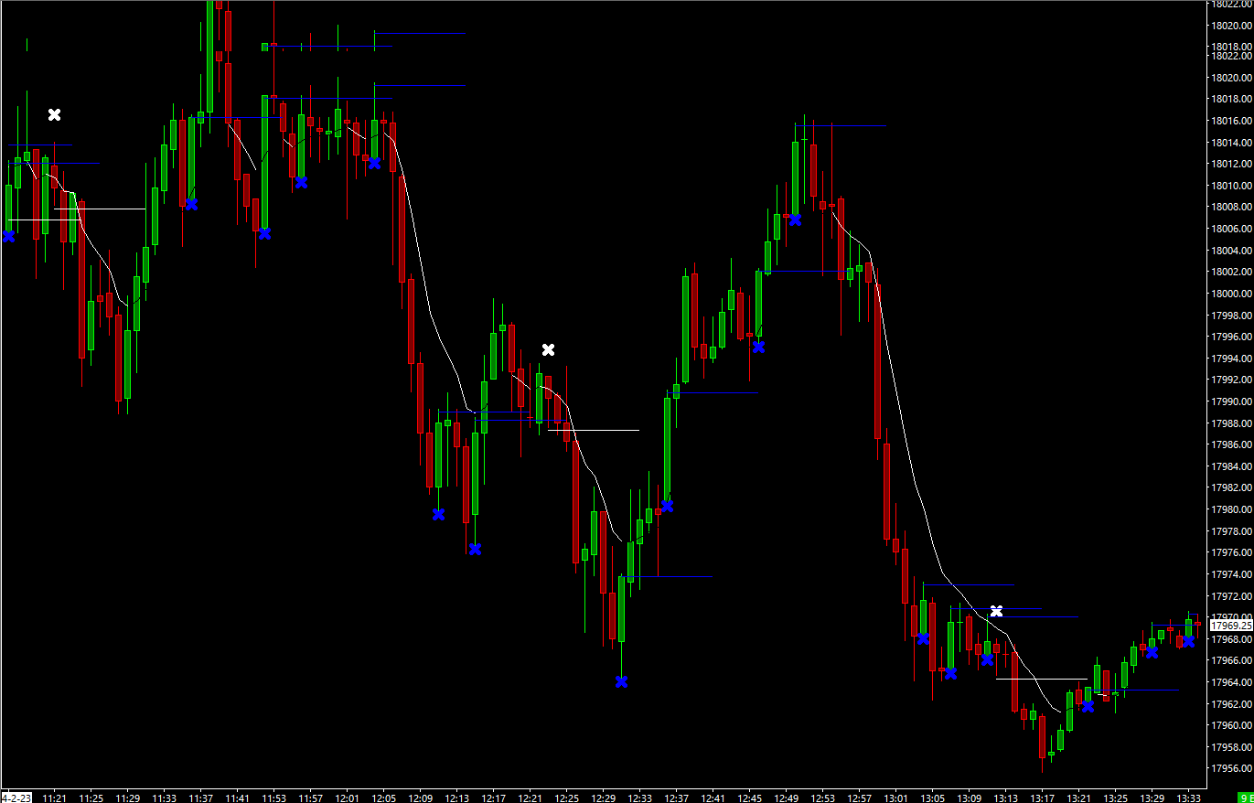

[2024-02-23 22:00:47]
User856926 - Posts: 9
So I followed some suggestions per Help topic30 High CPU Usage | Inactive User Interface | Poor Performance | Long Time to Load Chart Data | Charts Reloading Often
however, now my chart doesn't even finish loading even though the study looks like it completed. It's like it's stuck endlessly with the circular wait icon spinning. I have plenty of memory 64GB and an i9 processor so I it's not an IO issue. The charts will come up normally if I remove the study but I'm wondering why it hangs after it loads. It seems that there might be a parameter that I changed that is creating this behavior.
I tried:
Intraday Data Storage Time Unit: 1 Second -> 2 Second
Maximum Historical Intraday Days to Download -> 10
Maximum Historical Days to Download For Daily Data -> 10
Chart >> Chart Settings >> Data Limiting -> 10 days
I think there is a problem with the 2nd block of code however that is used to paint the blue X's. When I comment it out, the study shows up fine. The blue x's is just the reverse of the white's x's so I'm at a loss as to why the addition of this code causes a performance issue. It seems that 2nd block of code which is the same as the first block of code but for the price movement up is triggering some background event endlessly. I thought it might be the .AddMethod and tried different options instead of UTAM_ADD_ALWAYS but to no prevail.
image2024-02-23_13-43-53.png / V - Attached On 2024-02-23 21:44:19 UTC - Size: 35.69 KB - 225 views
[2024-02-23 22:56:01]
Ok...I found the issue.
I was using Autoloop and manual loop inadvertently. Now it's lightening fast. You can close the ticket.
