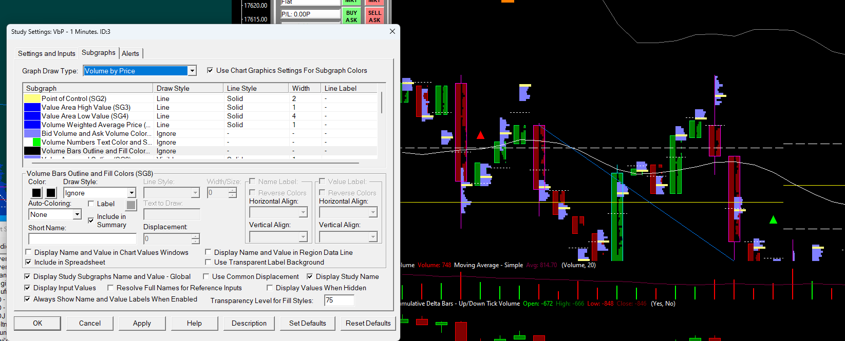

Owen_Jay - Posts: 15
I would like to show only the VbP study Value area. I have tried to ignore the Value area in the subgraph, however it still shows. If you look on the screenashot, you can see the black of the volume profile on the candle. the Value area and POC is in light blue and yellow POC.
Thanks for your help

[2024-02-22 18:05:02]
The reason you are seeing the profile in the candle is because you are setting the profile to be black, and since you are using a filled candlestick, it is displaying above the bar. The solution would be to set the option for "Draw Study Underneath Main Price Graph" for the Volume by Price study so that it is "Enabled" (has a checkmark). Then the profiles will be behind the bars (but this will also include the Value Area). Refer to the following:
Chart Studies: Settings and Inputs Tab >> Draw Study Underneath Main Price Graph (in the same Chart Region)
