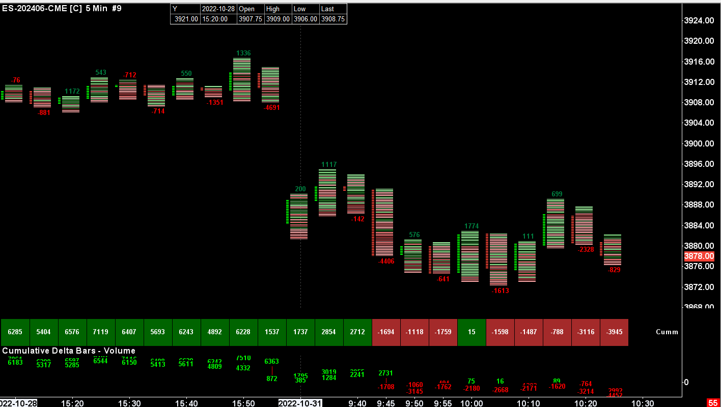

I tried to use the method like you told me to earlier, but that is not what I am looking for. I am not sure if you understood what I am looking for.
I want the values for each bar like in numbers bar calculated value.
I am attaching a screenshot of what I was able to do with the steps you told me, but thats not gonna work.
Its just a simple calculation that you'll have to implement to Numbers Bars calculated values. Really it shouldn't even take a lot of time. I'd greatly appreciate if you'll implement that, I am handicapped without those values. Its affecting my analysis and my trading a lot. You guys just need to replicate the formula like I said in post #1

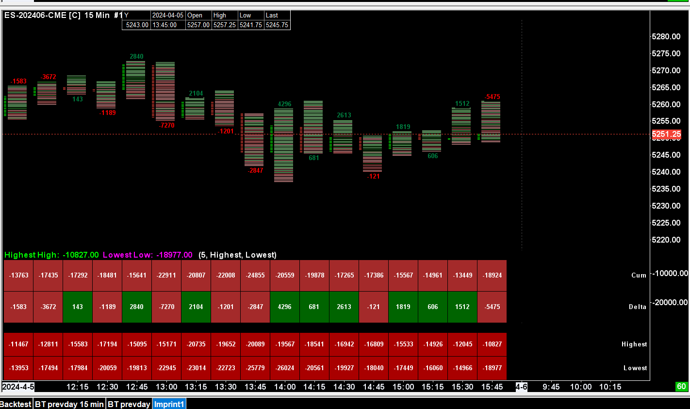

Hi, I was finally able to do what you said. (I didn't know that a separate study exits for Delta Values).
I am attaching a screenshot just so that we are on the same page.
Is this the best that I can make it display? because the issue that I am now having is that I need both the values HIGH and the LOW but I am not able to display it consistently below each other. I have to keep manipulating the scale which is cumbersome. I guess its because its using the bars high low coordinates.

You need to put each item in to it's own region.
[2024-04-22 16:29:49]
Jimmyy - Posts: 358
Oh damn. Thank you so much. Dont know why that didnt click to me
