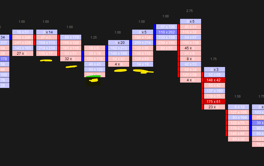

Could you pleasae guide me how to get delta displayed on bottom of numbers bars where yellow is marked like the range at the top?
I did have it a while ago but cant remamber how I done it..thx

Refer to the following:
Study Subgraph Above/Below Bar as Text
You would then need to have the Delta available in another study that can be referenced, such as the Numbers Bars Calculated Values. Refer to the following:
Numbers Bars: Displaying Numeric Information Below Numbers Bars
