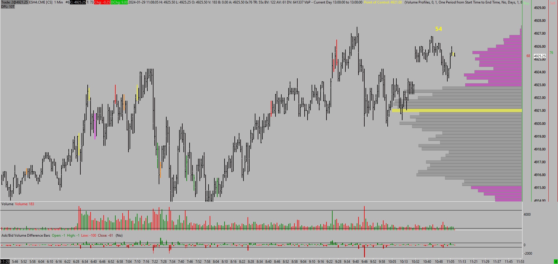

Hello, for some reason I am missing quite a bit of bars in my ES chart. On a 1 minute chart, the time jumps from 10:20am to 10:32am. And then from 10:55 to 11:05. I have tried to "delete and download data" multiple times and it still hasn't fixed the issue. I have also restarted Sierra Chart multiple times and still no luck. I am attaching a chart of the huge gap where it happens at 10:20.
imageBad Data.jpg / V - Attached On 2024-01-29 19:12:08 UTC - Size: 284.52 KB - 210 views

We see you are using Rithmic data. Therefore, refer to:
Rithmic Trading Platform Service: Rithmic Support Policy

Ok, I understand Rithmic isn't the best feed, but I have been with them for more than a year and have only had this issue very recently when I installed Sierra Chart on a new computer. I also have the Denali feeds activated through my Sierra Chart account, but it is still doing the same thing. It seems that the data does not load from whenever Sierra Chart is closed.

Another update, I just noticed that it now seems to be working fine for ES, but not for Nasdaq. But I have Denali feeds active for both CME and Nasdaq.

John - SC Support - Posts: 47955
Close all of the Chartbooks with "File >> Close All Chartbooks".
Open a single chart for the symbol you have an issue with through "File >> Find Symbol". Tell us that symbol of the chart. Tell us about *one* symbol only.

[2024-02-02 14:28:23]
ssangha84 - Posts: 132
It stopped doing this for a few days and then just started again today. I understand that rithmic data isn't the best, but I also signed up for the denali feed for historical data which should be running as well. That's why I thought it stopped doing this, when I got the denali feed.
[2024-02-02 14:52:10]
I am seeing this when I click Denali exchange data feed info: [Todo] Activate / Deactivate Denali Exchange Data Feed Exchanges [CME / CBOT / NYMEX / COMEX]
I'm assuming this is why its happening. But when I click to activate, its not giving me any options for non professional packages.
[2024-02-02 17:28:05]
We see that you have activated the "CME with Market Depth for Non-Professional Trading Accounts". We also see that you have deactivated it, but you will still get the data from us through the remainder of this month. By deactivating it, you are setting it to not renew.
If you are still having an issue then pick one symbol for which you are having the issue, and let us know the symbol and the particular problem. Then get us your Message Log by following these instructions (we need you to follow the instructions exactly in order to get us the information for just one symbol):
