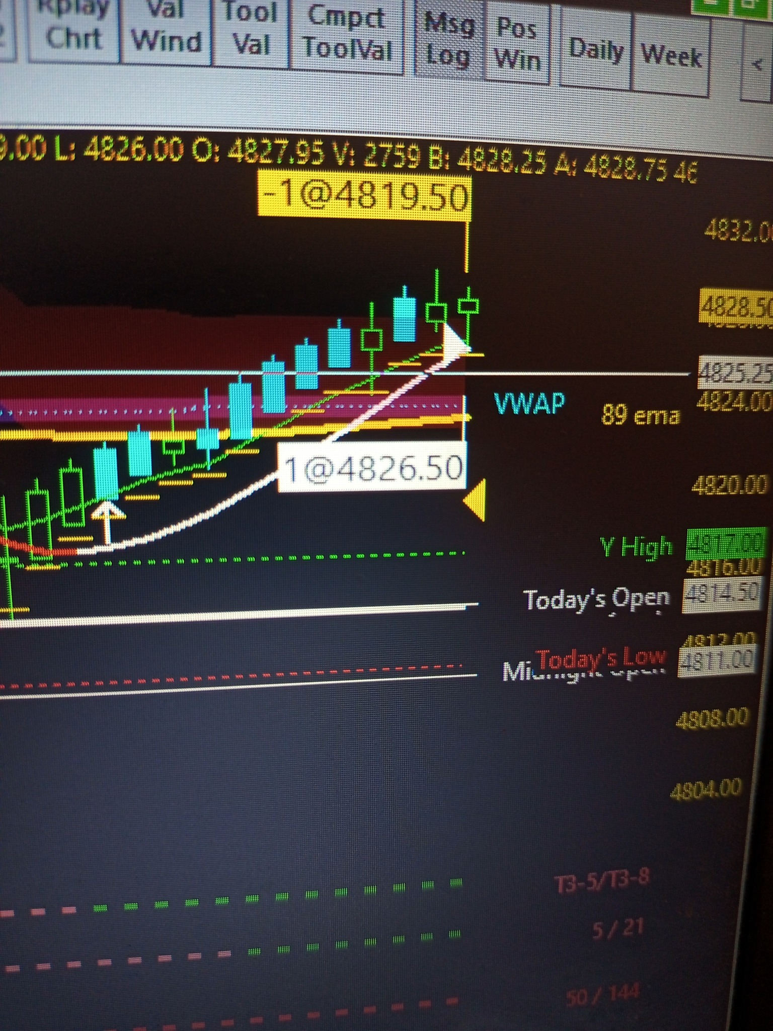

Hola, actualmente tengo una cuenta activa con AMP FUTURE,
tengo activado el comercio atreves de TETON.
Y tengo un Bot S3 de trading automático.
Cuando una operación se realiza la entrada es mucho mas arriba de el tiempo en que esta el precio actual.
Al parecer va retrasado el grafico que me muestra.
Adjunto una foto del grafico,
La flecha blanca es donde entro en compra y la amarilla es donde salió.
Me puede ayudar, gracias!

Hello, I currently have an active account with AMP FUTURE,
I have activated trading through TETON.
And I have an S3 automatic trading Bot.
When a trade is made the entry is much higher than the current price time.
Apparently the graph it shows me is delayed.
I attach a photo of the graph,
The white arrow is where I entered the purchase and the yellow one is where I exited.
Can you help me, thank you!
You are not setup to get the real-time data from us.
The first issue is that you are currently on the "Base Standard" package. In order to be able to connect to your trading service and have the ability to get real-time data, you would need to be on one of our "Integrated" packages. Refer to the information here:
Description of Service Packages and Pricing: Integrated Packages
You can change your package at any time by selecting a different option at the following link, and then selecting the "Update/Set" button:
https://www.sierrachart.com/UserControlPanel.php?page=ServicesActivation#ServicePackage
When you change your package, you do not need to add funds, nor do we give a refund. Rather, we adjust your remaining Usage Time based on the difference in price between the packages. Therefore, if you change to a more expensive package, then your remaining Usage Time will go down, and vice versa.
Once you have the package setup properly, then you can setup the data you need by following the instructions at the following link:
And finally, in order to connect to your trading account, follow the instructions at the following link starting at step #6:
Sierra Chart Teton Futures Order Routing: Setup Instructions

Hola
Cambie el paquete al 10 integrado y active los datos de CME group.
Pero no puedo ver el grafico TPO para SP 500.
Hay algo mas que necesite hacer?
Ya tengo los datos en tiempo real para el SP 500?
Gracias
[2024-01-23 16:56:49]
The TPO Charts are only available with the "Advanced" packages. Therefore you would need to change to the "Integrated Advanced" package (Package 11) to have access to the TPO study. Refer to the following:
