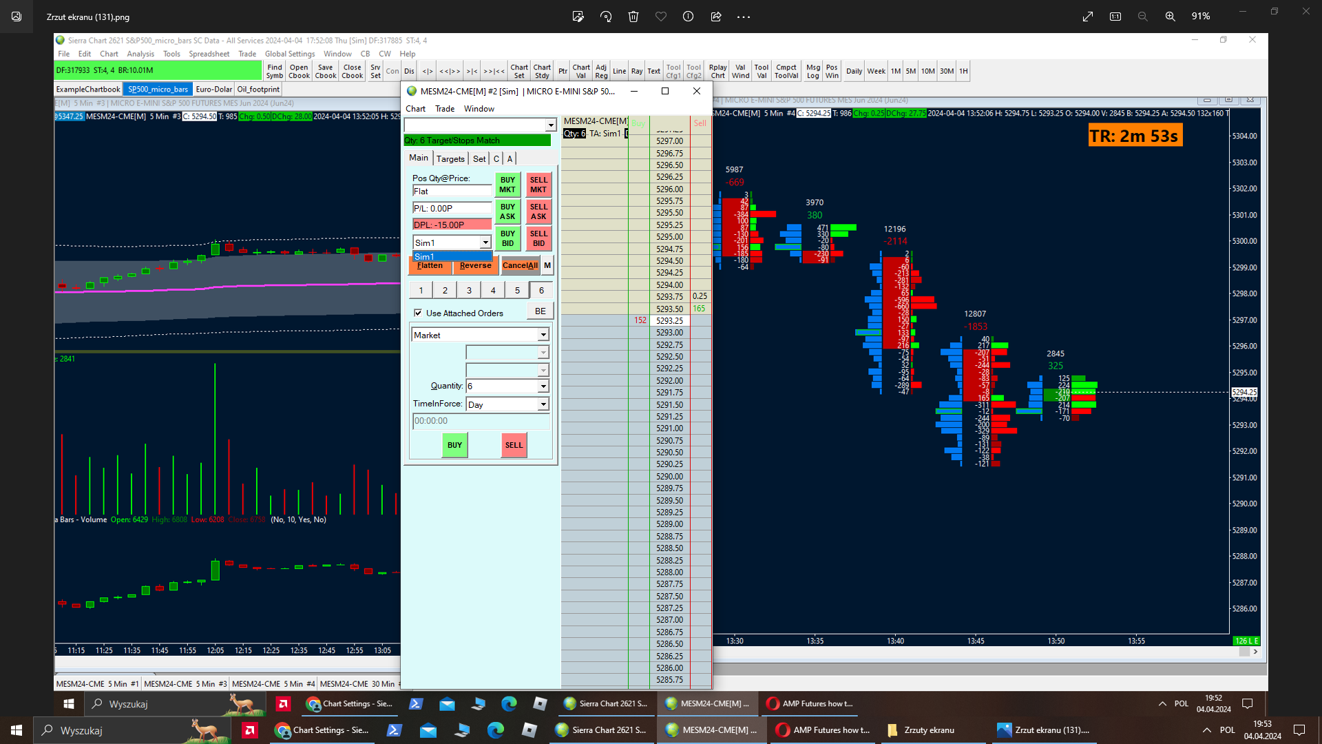

User534710 - Posts: 7
My trading account was previously available in the window where sim1 is located and it disappeared. I haven't used Sierra for some time. Do I need to activate it again in AMP?
imageobraz_2024-04-04_195704995.png / V - Attached On 2024-04-04 17:57:10 UTC - Size: 431.05 KB - 3815 views
[2024-04-04 21:28:31]
It depends on what you are wanting to do. What is the reason you want to see the previous account?
Also, when you connect to AMP, if you still have that same account, then it will be available for selection.
I mean, I could switch between the demo and the real account and now there is no such option, there is only the demo. So how can I start playing on a real account on Sierra?
[2024-04-05 15:26:17]
If want to use your real account, then you need to connect to your trading service. Are you setup to connect to your AMP account using CQG or Teton?
[2024-04-05 19:43:26]
Thank you, I did not change the Data/Trade service
[2024-04-05 21:03:42]
Our servers show that your "Global Settings >> Data/Trade Service Settings >> Main Settings >> Current Selected Service" is set to "SC Data - All Services". This means that you are only connecting to Sierra Chart and not to your trading service. This is fine for testing and learning, but to be able to trade live, you need to connect to your live trading account.
We can point you to the proper instructions to connect if you let us know if you are using CQG or Teton for your order routing with AMP.

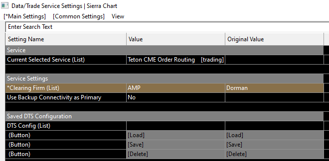

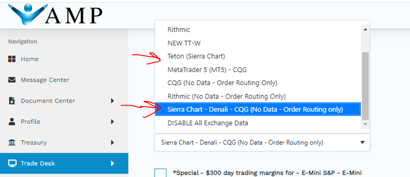

User566250 - Posts: 37
I am trying to add AMP (already have Dorman) but have not been successful. On the AMP website I can see service requests for either the Teton or Teton routing only. (Please see screenshot below). I am assuming one of those two need to be enabled vs what is assigned now which shows CQG (no date, routing only).
I tried adding my AMP account to SC through the Data/Trade Service Settings but it did not do anything and the account did not get listed in the drop down menu for the Trading panel.
Please advise.

[2024-05-14 21:43:15]
You are either setup with CQG or Teton with AMP. From what you show, you are setup with CQG, in which case you need to follow the instructions at the following link to connect to your CQG account:
CQG Trading Platform Service: Setup Instructions
If you want to use our Teton Order Routing Service with AMP, then you need to change your setup with AMP first and let them know that you want to change from using CQG to Teton. And refer to the following instructions for how to setup the Teton Order Routing Service:
Sierra Chart Teton Futures Order Routing: Setup Instructions
