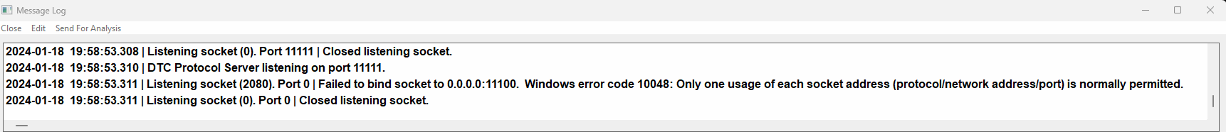

Sub instance keeps opening message log by itself periodically.
Attaching the screenshot for reference.
imageScreen Shot Thu 01 18 2024 at 8.03 PM.png / V - Attached On 2024-01-18 14:34:52 UTC - Size: 18.84 KB - 302 views
[2024-01-18 16:46:18]
In the Sub-Instance set "Global Settings >> Sierra Chart Server Settings >> DTC Protocol Server >> Additional Listening Port" to "0".
Then restart the sub-instance.

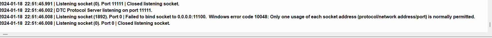

It just happened again after setting the port to 0 . Attaching the SS

[2024-01-18 17:28:55]
Jimmyy - Posts: 356
I checked the port was changed back to some 11100 number. I have changed the port to 0 on both main and sub instance and restarted both. It is at 0 now.

[2024-01-19 00:10:56]
You do need to do this in the main instance:
Set "Global Settings >> Sierra Chart Server Settings >> DTC Protocol Server >> Additional Listening Port" to "0".
Its remembering the main instances' location but not the sub instances.
Might be related to this setting:
General Settings Window: Always Copy Configuration Files to New Instances When Started (Global Settings >> General Settings >> General >> New Instances)

Jimmyy - Posts: 356
Do You mean i need to or i dont need to? i did it in the main instance too and it seems to be working fine now.
This solved the problem. Thank you so much
