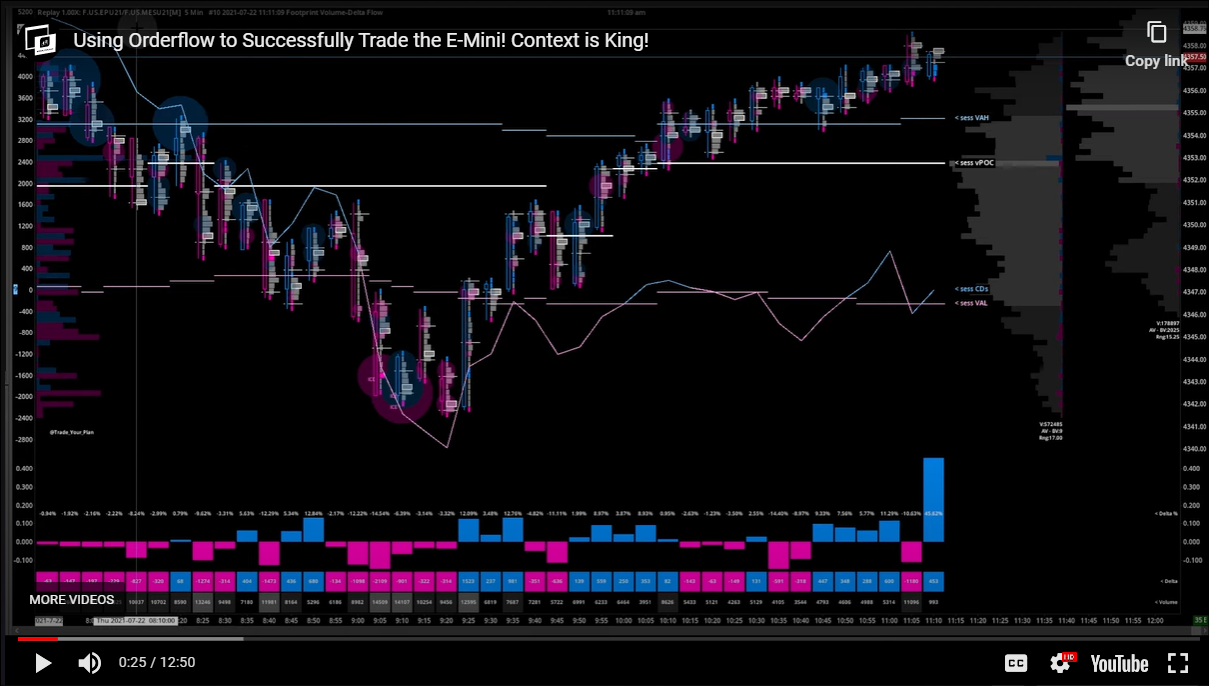

I recently saw a YouTube video which featured the Sierra Chart Numbers Bars Calculated Values study.
The study displayed the Ask Volume Bid Volume Difference Percent (SG11) subgraph.
Please advise how I can display this subgraph in the format as illustrated in the following link.
https://www.sierrachart.com/Download.php?Folder=SupportBoard&download=94319
Thank you in advance for your support.
Warmest Regards
AndyB
imageNBCV Delta % Setup.png / V - Attached On 2024-01-17 21:26:37 UTC - Size: 422.12 KB - 375 views

In the attachment, the data for SG11 displays in variable heights. I can only get it to display in static heights based on the row scale. I could not find in your 2 links where I could do this.

Use the study 'Study Subgraph Reference', set the input value to your Numbers Bars Calculated Values SG11.
Draw style Bar
Increase Width/Size
Auto Coloring based on +/-
Hope that helps

@LudaTrades. Thank you for your suggestion. Your method displays the bar data correctly, but it doesn't display the values for each bar as does the Numbers Bars Calculated Values. Hopefully SC Support has an easy resolution. :)

If you want the percentages in the same region as the bars, set a Numbers Bars Calculated Values study to that same region
Transparent Text Background Yes
All Subgraphs Ignore except SG11
Grid Lines (SG55) Ignore

LudaTrades has the right ideas, but rather than using the "Bar" Draw Style, you would want to use the "Fill Rectangle to Zero".
Even though you will not see a scale on the right, you can adjust the location of the bars by dragging in the area where the scale would be. Or you can turn on the Left Side Scale so you can actually see and change the scale there.
