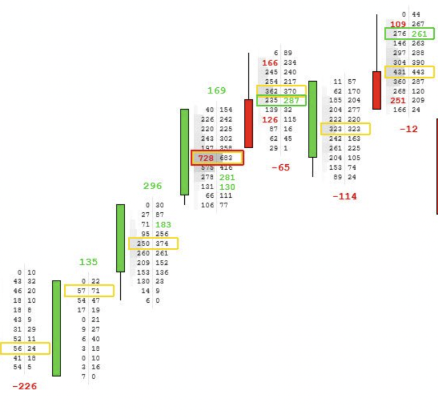

Hello. Hopefully I can explain this well enough. I will attach 2 images for reference.
My numbers bar chart is not displaying the 2way auction correctly.
In the first image (filled candles) is a reference I found of a numbers bar chart on Sierra chart from google, as you can see on the top and bottom of candles its occasionally printing "0"s displaying the proper auction.
In the second image (hollow candles) is an example of my chart in Sierra chart and every candle is printing values at the highs and lows and not displaying the proper auction. How do I fix this?

When there is a non-zero value it is an unfinished auction. This does occur.
But we do agree that for most liquid symbols having that number of bars having unfinished auctions seems a bit odd. What is the symbol you are viewing?

This is ES.
It is the same no matter if i change time frames or chart type, it still displays every candle as unfinished auction. Not sure how to fix it.
