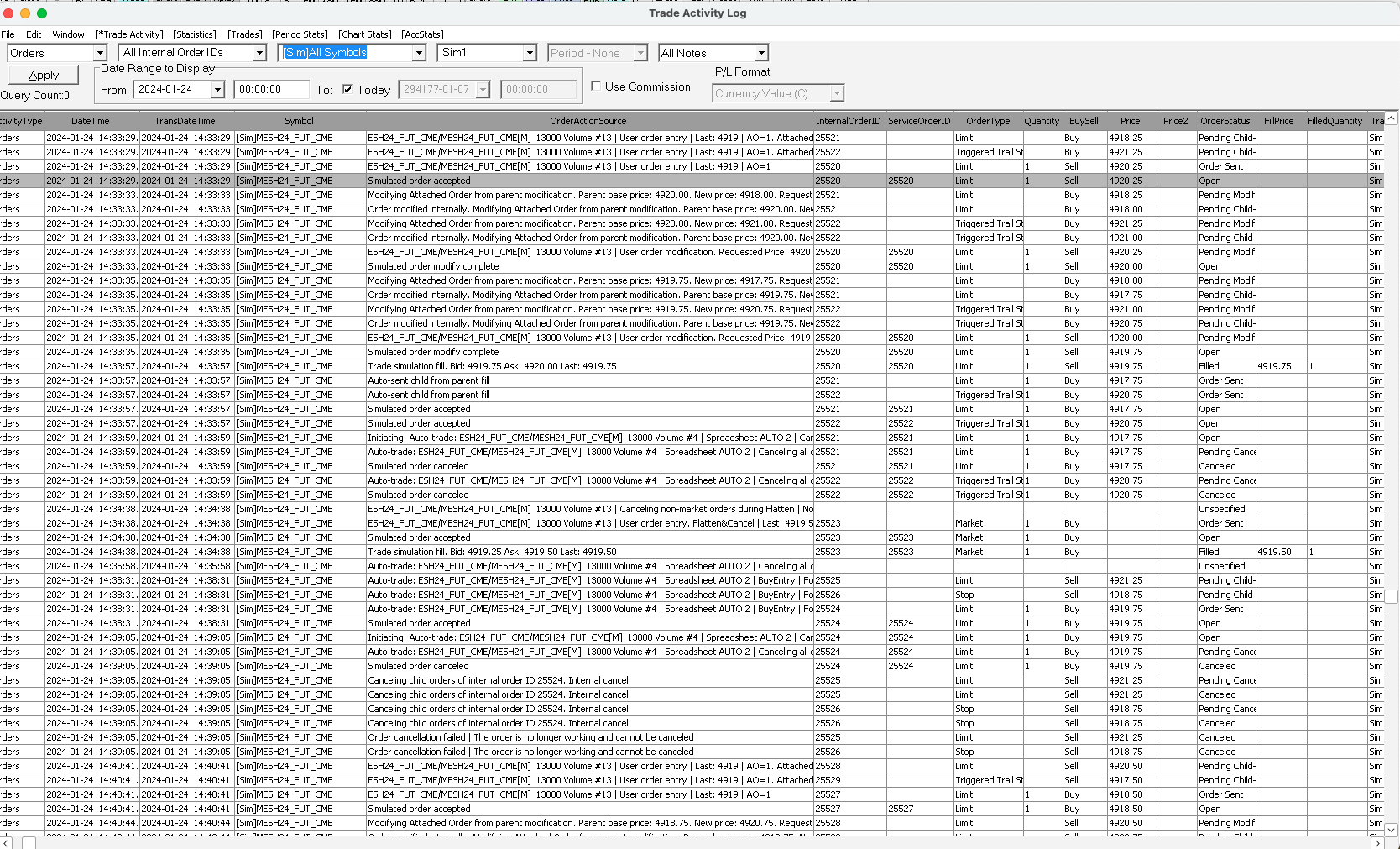

I just had this happen again, luckily in SIM, where my TP and SL just disappeared and I had to manually flatten the position. Here is the Trade Activity Log showing the "Orders" for the Short sale at 14:33:29 where it happened.
Can you explain what happened and how I avoid this?
imageScreenshot 2024-01-24 at 14.51.52.png / V - Attached On 2024-01-24 14:52:03 UTC - Size: 196.01 KB - 309 views

We see the following about midway in the log:
Auto-Trade ESH24_FUT_CME/MESH24_FUT_CME[M] 13000 Volume #4 | Spreadsheet AUTO 2| Cancelling all...
Following this, the working orders were cancelled. So there is something in the Spreadsheet System for Trading that you have set that caused this to occur.
