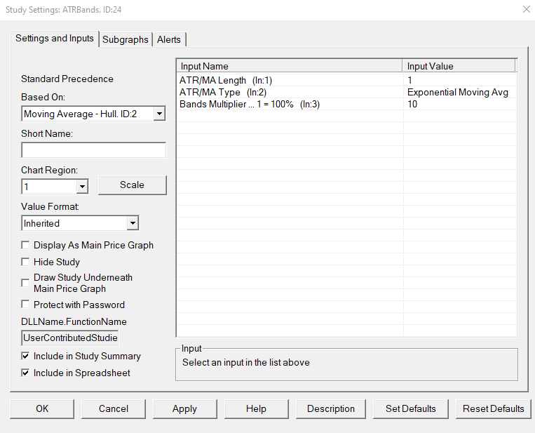

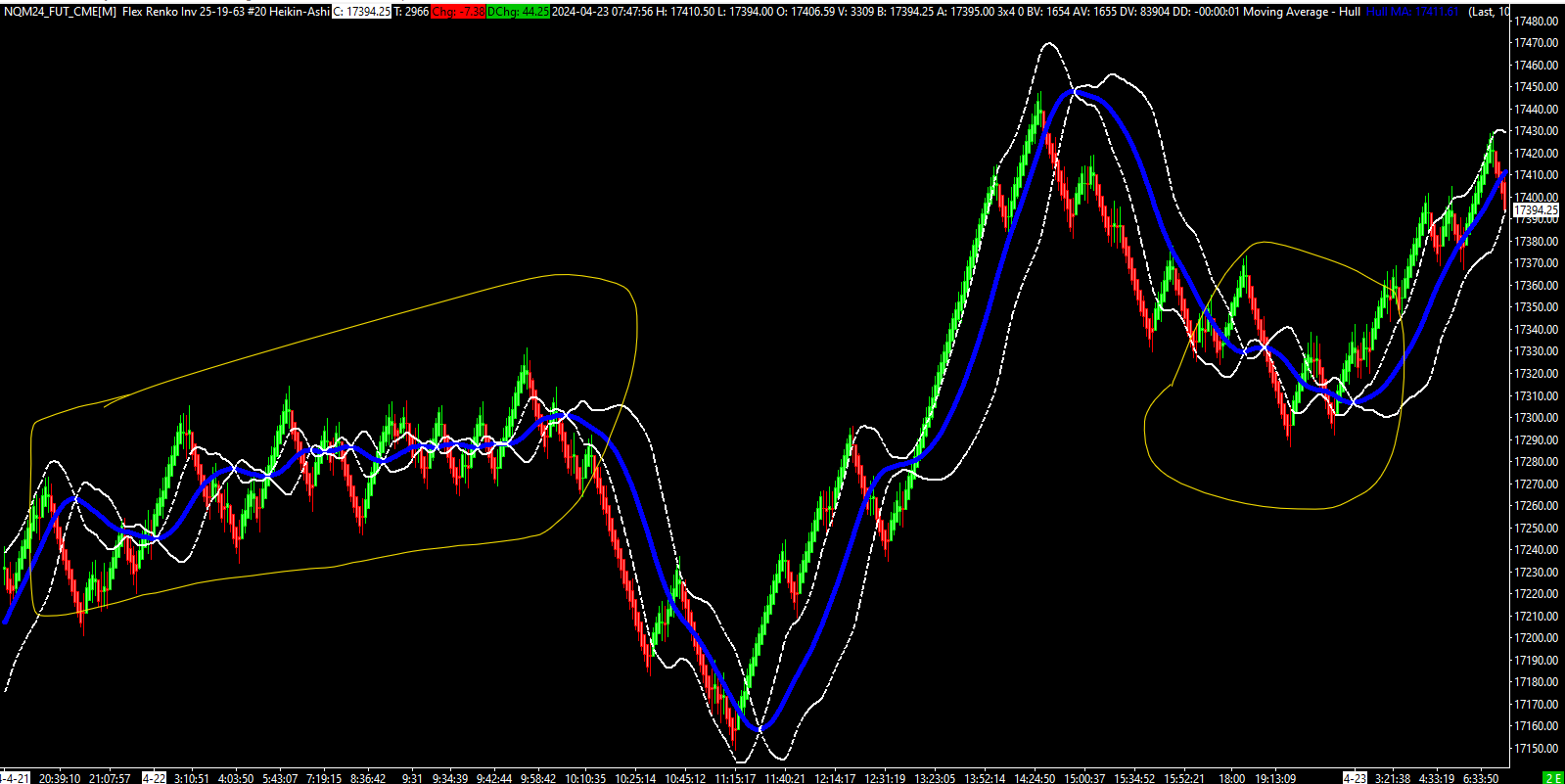

So I believe I followed your instructions utilizing the ATRBands study (user contributed) with 2 different MAs. The first being the HULL with a 100 length and I believe I may be doing something wrong because at some points (yellow circle) the bands cross each other and the HULL itself.

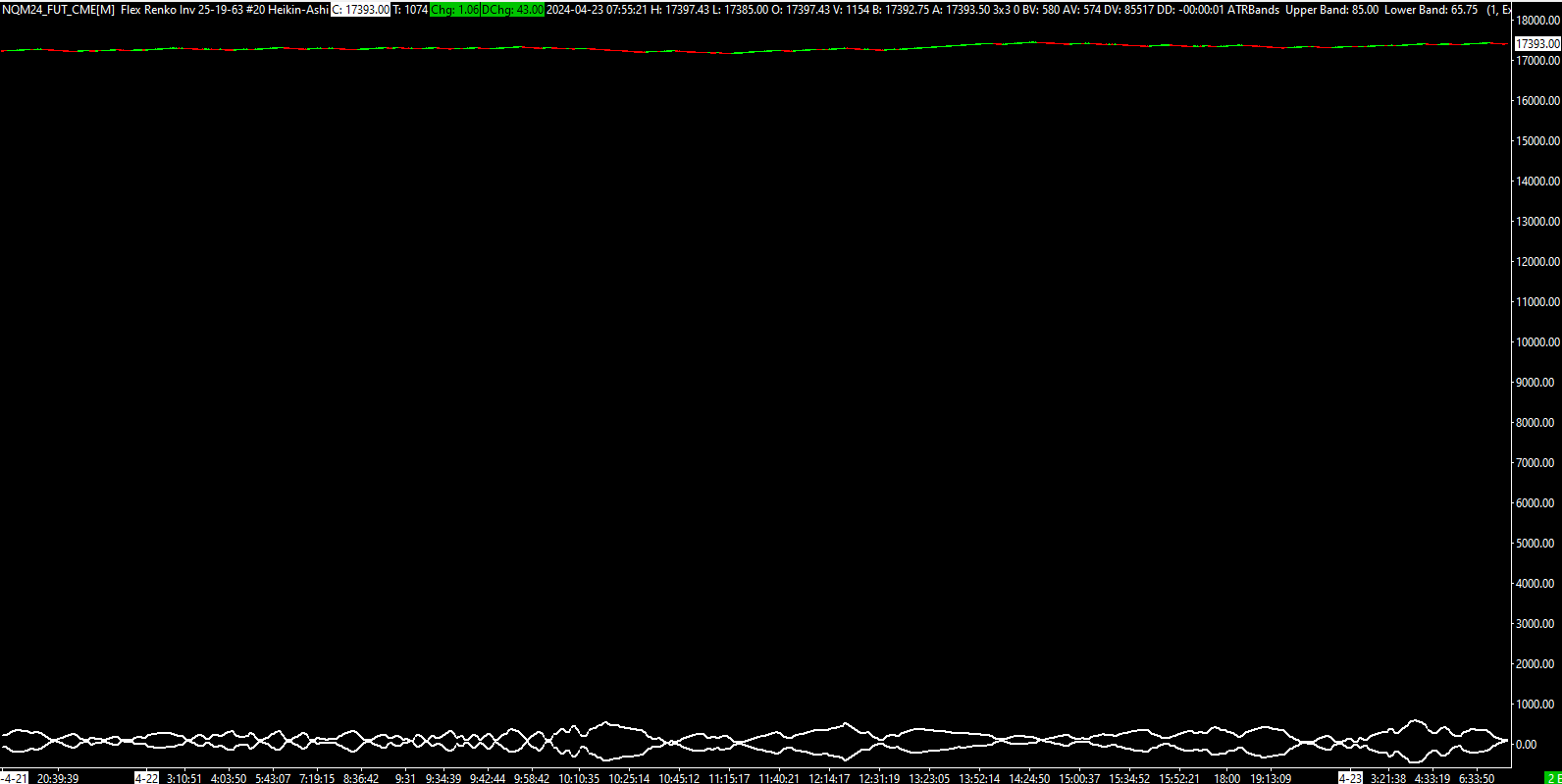

The second MA is user contributed and is AMA: Adaptive Stochastic Moving Average With Filters. When that is placed it completely minimizes that chart
imageScreenshot 2024-04-23 074838.png / V - Attached On 2024-04-23 11:51:44 UTC - Size: 89.74 KB - 274 views
imageScreenshot 2024-04-23 074637.png / V - Attached On 2024-04-23 11:51:51 UTC - Size: 33.4 KB - 306 views
[2024-04-23 11:54:03]
User411320 - Posts: 379
File attached
Date Time Of Last Edit: 2024-04-23 11:55:50
imageScreenshot 2024-04-23 074729.png / V - Attached On 2024-04-23 11:53:57 UTC - Size: 33.64 KB - 237 views
imageScreenshot 2024-04-23 075529.png / V - Attached On 2024-04-23 11:55:47 UTC - Size: 31.02 KB - 261 views

We are not sure exactly what you are doing or how you have this setup, so we can not respond to the question of the crossing.
In terms of the study that is messing up the chart, that is because the data is close to zero. So the chart is trying to display the data at both 0 and 17393. You would have to look into how that other study is setup to determine why it is giving numbers close to zero. Another option would be to change the scale to Independent for that study, but this would probably defeat the purpose of what you are trying to use it for.
