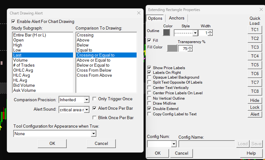

Hi All,
I am using extended rectangles to mark my areas of interest. I configured these rectangles to trigger an alert once the price is equal/crossing the boundaries.
The alert usually works well for some time, then suddenly I stop getting the alerts without any change in configuration from y side. The alerts window also stops showing the crossing/equal event.
I have been having this issue for quite some time now and I am not able to figure it out. Attached are the settings I am using.
Since it is not even showing in the alerts log, I am stuck and don't know how to troubleshoot this,
The exact same alert settings on a simple horizontal line work without any issues.
Can you give me any advice on how to investigate this further to find the root cause?
imagealert_config.png / V - Attached On 2024-01-04 11:57:15 UTC - Size: 57.86 KB - 248 views

One thing I am suspicious of is that I put the configuration to "alert once per bar" and the rectangle is on a TPO chart which doesn't really have bars. Would this cause any issues?
Date Time Of Last Edit: 2024-02-07 17:04:52
[2024-02-07 17:41:27]
John - SC Support - Posts: 47955
Yes, this would definitely be the cause. We kept removing the TPOs to have a simplified chart for testing, which is why were not seeing it (or thinking of it). But we tested again with your chart with the TPOs and as you suggested, there is an initial alert, then no more, and there is no bar timing to cause a reset.
You may not want to use the alerts on the TPO by turning off the option for "Alert Once per Bar", as you will then get a number of alerts when the price is right at the rectangle edge, although setting it to crossing should help. But you might want to setup another chart with a specific bar period to get the alerts.
