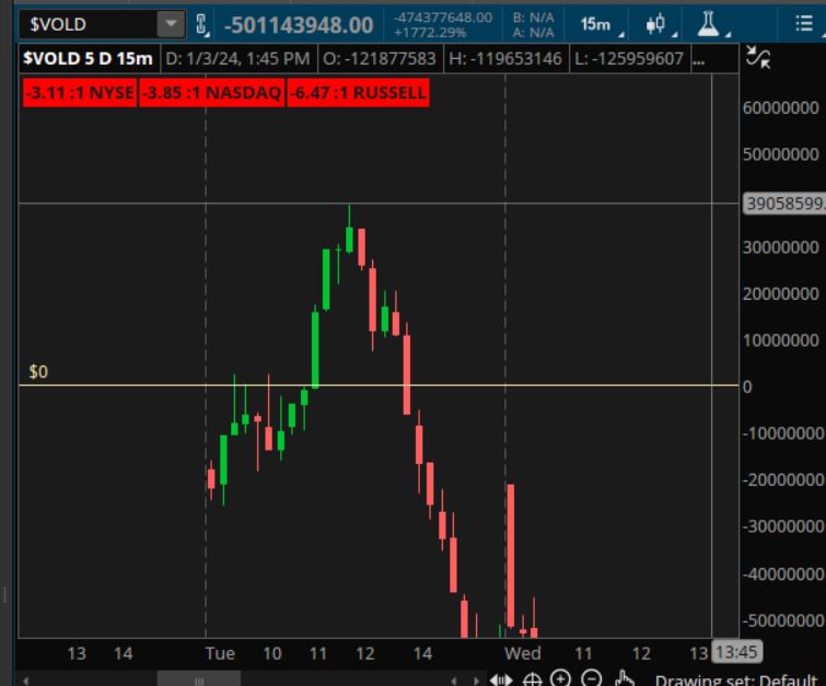

I have a quadrant on my TOS chart with market breadth data displayed in ratio bubbles in the top corner as shown in the attachment.

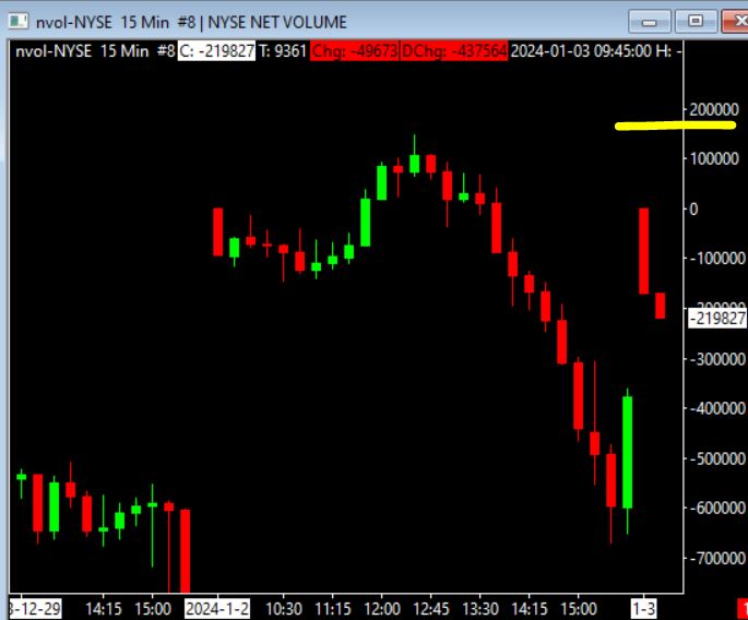

Also, what would $VOLD (Uvol-Dvol) be on Sierra Chart? I have pulled up NVOL-NYSE but it doesn't seem like the equivalent to what I see on VOLD on TOS or Tradingview. Tues Jan 2nd session reached highs of 39000000 but only cracking 200000 on NVOL
imageVOLD.JPG / V - Attached On 2024-01-03 23:13:19 UTC - Size: 23.56 KB - 593 views
imagebreadth.JPG / V - Attached On 2024-01-03 23:20:12 UTC - Size: 110.19 KB - 555 views
imagenvol.JPG / V - Attached On 2024-01-03 23:37:02 UTC - Size: 43.26 KB - 574 views

We can not help with the Breadth code. If you give us an image of what you are trying to accomplish in Sierra Chart, then we can tell you if it is available and how to do it.
With regards to the Up Vol - Down Vol, the statistic in Sierra Chat for this is NVOL, so you have the correct symbol. Refer to the following for the Sierra Chart Market Statistics:
We can not say why there are differences between systems in this data. You would have to understand how each system is performing their calculations.

I am looking for bubble to appear on the chart showing the difference between UVOL/DVOL for NYSE, NASDAQ and the Russell. I have an image attached of how it looks on TOS and I am trying to replicate it on Sierra charts.
imageVOLD.JPG / V - Attached On 2024-01-30 20:28:03 UTC - Size: 49.88 KB - 565 views

We have Market Statistics for the UVol/DVol ratio which you can then reference using the "Text Display for Study from Chart" in order to get the ratio displayed on another chart.
Refer to the following:
Text Display For Study from Chart

John, I don't see a ratio for the UVOL/DVOL, only the 24HR version is listed and I assume that will not give the same results as getting the ratio during market hours?
[2025-03-27 13:47:43]
You would have to have charts open for both UVOL and DVOL and then use the "Bar - Ratio" study to create the ratio of these charts. Refer to the following:
Ratio (Bar)
