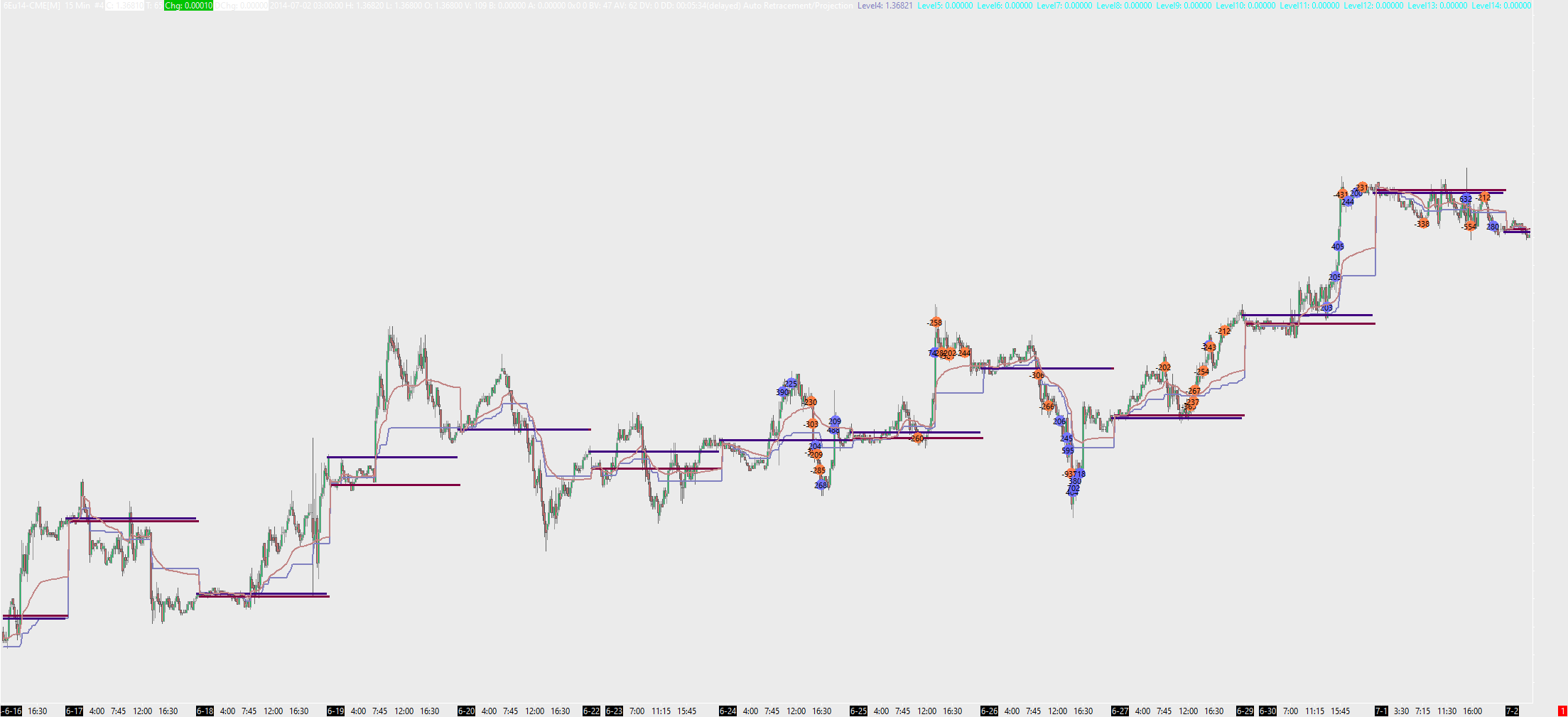

Hi There,
The data on the large volume indicator terminates on June 24 2014. I have no problem from June 24 2014 to the current date.
Is there a way to get more data from an earlier date for the large volume indicator?
https://www.sierrachart.com/image.php?Image=1703500724480.png

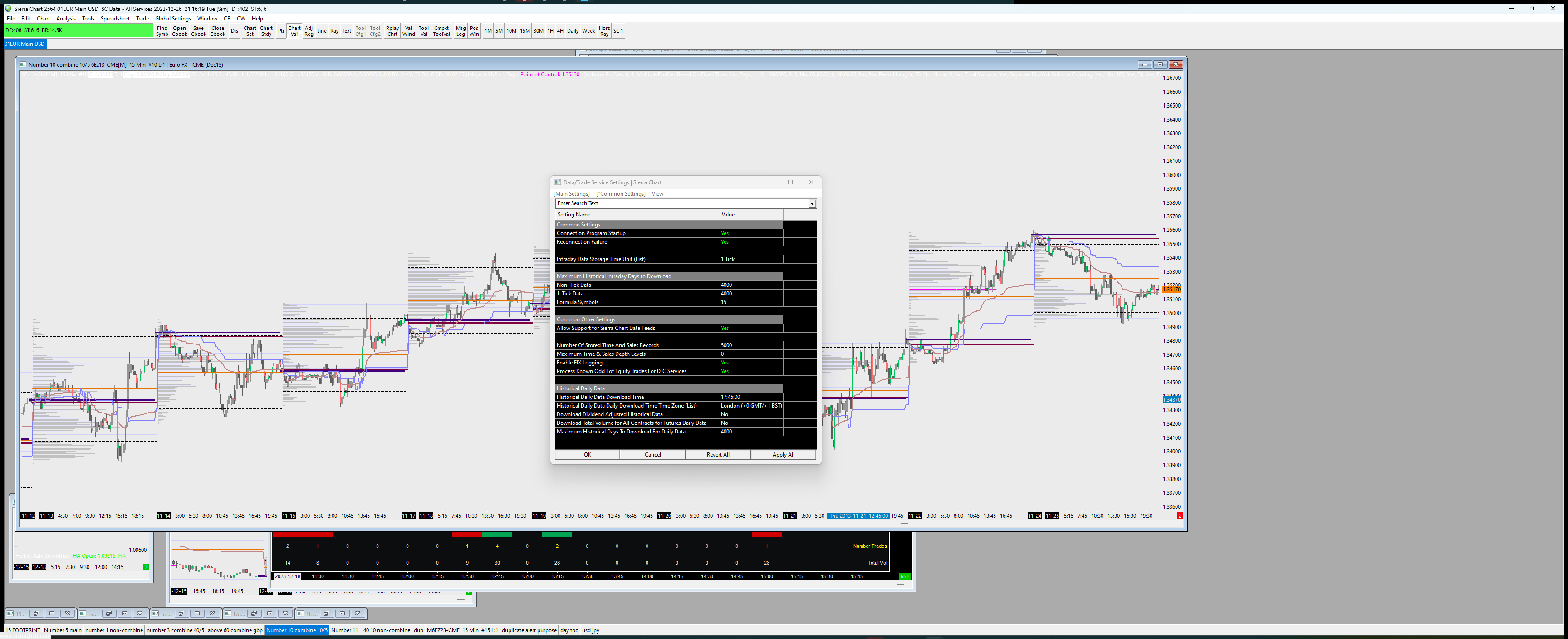

Hi There,
Thank you for your response
I did follow the instructions but still don't have the data earlier than June 2014. Do you have another suggestion?
https://www.sierrachart.com/image.php?Image=1703625381724.png this is 2013 with no large trade indicator showing up
Ernie
[2023-12-27 04:47:06]
This means the data is not tick by tick.
