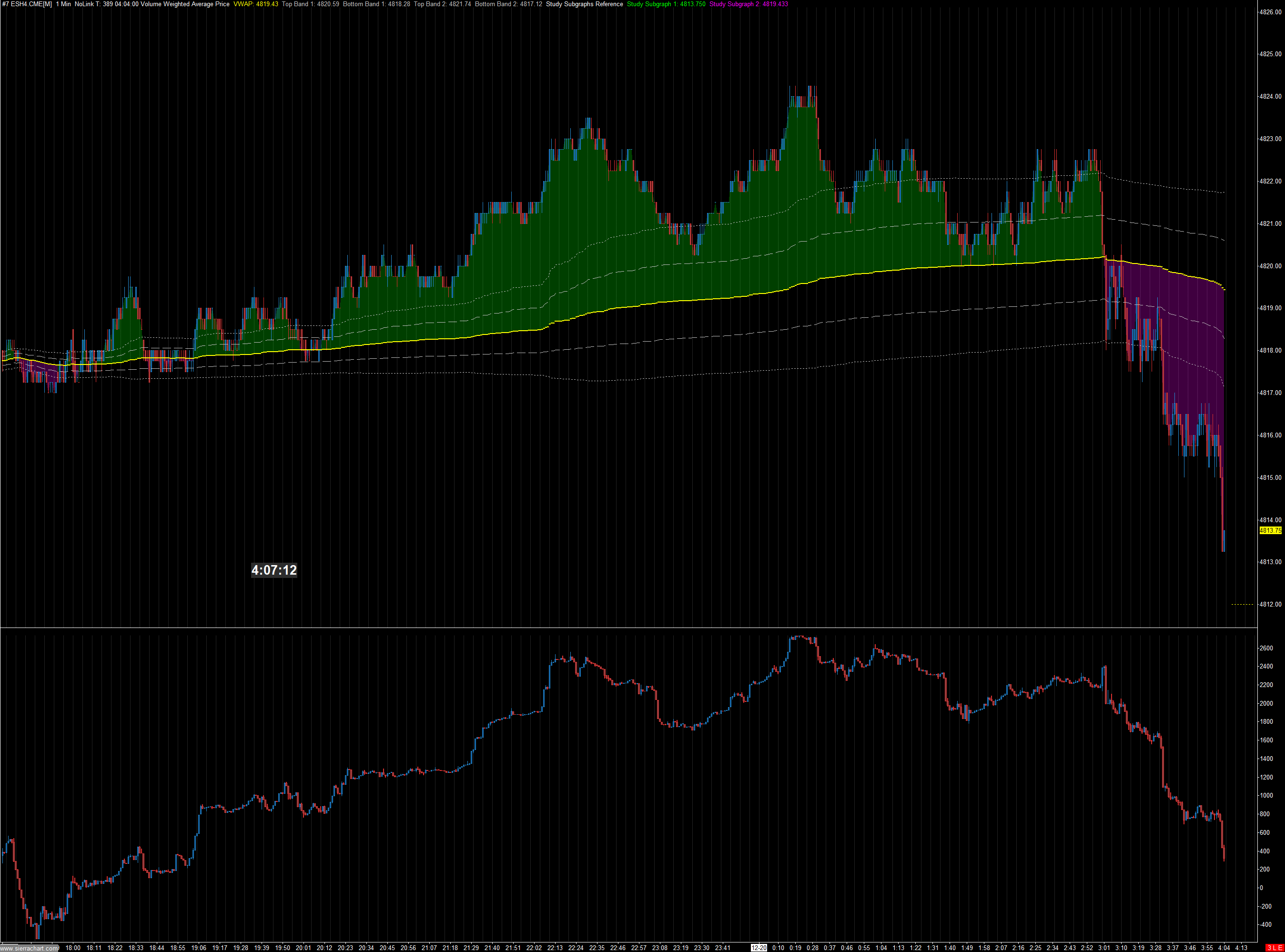

I've used the method referenced in Chart Studies: Filling the Area Between Two Study Subgraphs within Different Studies to fill the area between the VWAP study (VWAP value SG1) and the main price.
In 1 min charts, it works initially but as the time progresses, or the horizontal scale is changed the fill has a vertical offset.
This offset may be fixed after some time (or not)
Two screenshots are shown here.
One correct and one with vertical offset.
https://www.sierrachart.com/image.php?Image=1703063233253.png
https://www.sierrachart.com/image.php?Image=1703063388941.png

John - SC Support - Posts: 48444
Set the Scale for the "Study Subgraphs Reference" to be "Same as Region".
By default, this is set to "Independent", which is why it is not in the correct location.

gtaranti - Posts: 99
Yes, this fixed it.
Thank you, for your prompt reply and solution...
