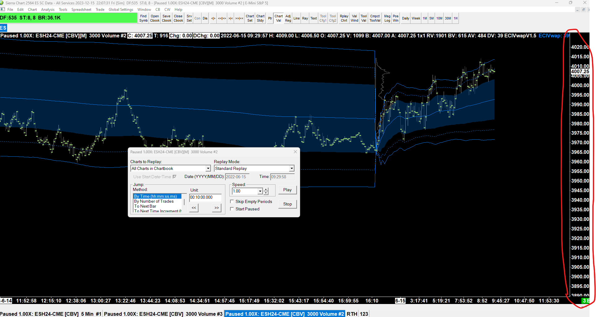

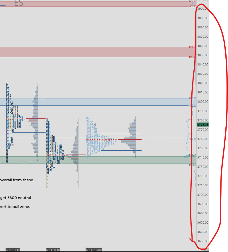

I wanna use market replay but whenever I go back, the prices on the Y axis is not updating to the prices of that particular selected replay time. I have attached 2 photos explaining what I mean (I have attached levels that was created on 06-15-2022 and trying to replay the same date in Sierra).
Kindly help me out with this.
Thank you

[2023-12-16 13:14:47]
Dhanush - Posts: 23
No problem, I will try to explain again. Basically, I wanted to replay my chart for the date 06-15-22 and use the levels that are marked in 2.png (The levels were made on 06-15-22 by someone. I am using it to practice execution). However, the prices at which the levels were made in 2.png and the replay chart ( 1.png) price action are not the same. For example, in 2.png, there is a green level thats anchored at 3740.75 & 3733.25 and if I use the same prices at the replay sierra chart, there won't be anything because the price action in SC is up by around 200 points approx. Only if I get my chart price action to around 3700 - 3800 will I be able to plot the levels accurately in SC and do execution practice.
Hope this was clear. Thank you
[2023-12-17 19:59:29]
Do not use one of the back adjusted Continuous Contract options:
Continuous Futures Contract Charts: Continuous Futures Contract Rollover Options
