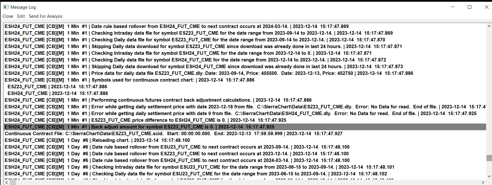

1. Yes, The day MAR24 does show, See attached pic of Message Log that says "Back adjust amount for symbol ESZ23_FUT_CME is 0"

1. The reason why your rollover amount was 0 was due to the lines in your log that reference a problem getting the data from the Daily data files. Please open daily historical charts for ESZ23_FUT_CME and ESH24_FUT_CME and let them load the data. You can then close those charts.
Then go to the ESZ24_FUT_CME chart that is not showing the rollover and select "Chart >> Reload and Recalculate". Let us know if this resolves the issue.
