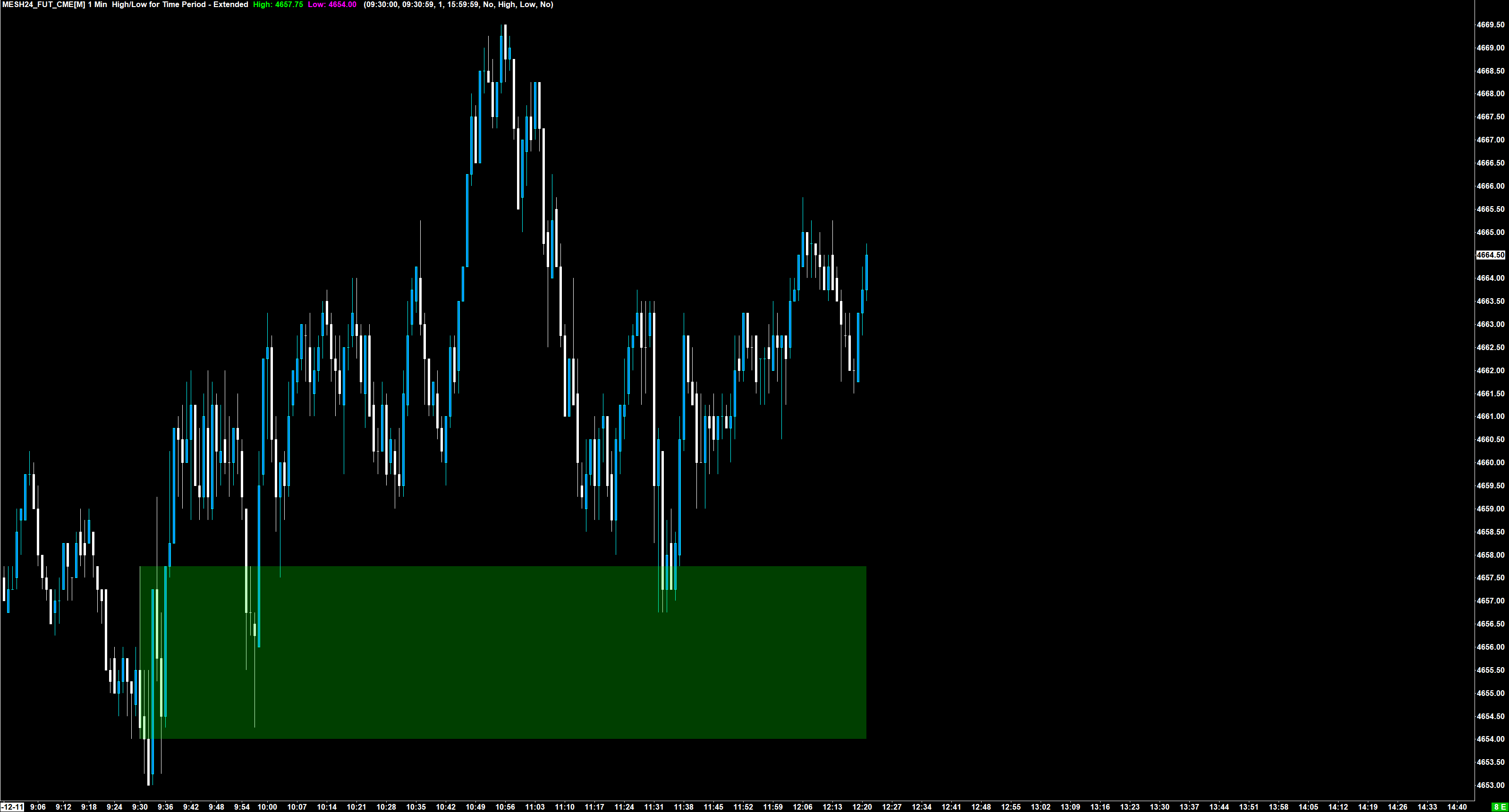

D.Vicious - Posts: 26
Thanks for the reply!
Verified the Draw High Low Incrementally is set to No, still not displaying to the Line Stop Time. Attached images and chartbook for review.

[2023-12-11 19:42:22]
John - SC Support - Posts: 48440
So you are wanting to have the lines extend into the future from the last bar?
If this is the case, then you can do it, but you will not be able to fill the area between the lines. You would need to set the High and Low subgraphs Draw Style to "Line Extend to Edge". Refer to the following:
Chart Studies: Line Extend To Edge (ACSIL: DRAWSTYLE_LINE_EXTEND_TO_EDGE)
[2023-12-11 20:14:49]
Correct, extending into the future to the Line Stop Time configured. I played around with the extend line to edge option but things start to get wonky with how I am using multiple High/Low studies. End Goal would be what I have attached, a 1min, 5min & 15min zone. Understood it is not possible with the transparent fill style. Guess I'll have to jump into custom studies sooner lol
