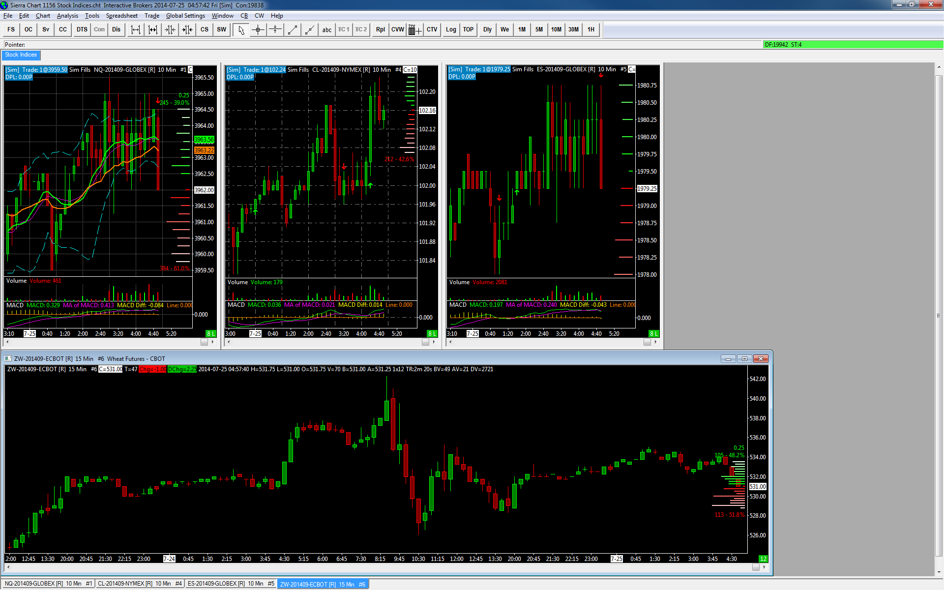

imageChart_Settings.png / V - Attached On 2014-07-25 08:59:36 UTC - Size: 78.69 KB - 545 views
imageChart_4_symbols.png / V - Attached On 2014-07-25 08:59:43 UTC - Size: 143.64 KB - 581 views
[2014-07-25 12:01:21]
User11942 - Posts: 298
Update. I've restarted the machine and now it's working as it supposed to. And maybe I was too fast switching between ICE symbols/SC copies (or IB's API was too slow). However, the problem seems to be resolved for now. Thank you for your support anyways.
[2014-07-25 17:23:37]
This is good. What we were going to have you do is restart Sierra Chart again, and open one new chart from a remote instance through File >> Find Symbol and let us know if a market data request to Interactive Brokers occurs. It should not. We tested this.
The only explanation is although these charts you have posted an image of, are identified as using data from remote instance, they may be using data from the same instance.
We are going to add additional logging to Sierra Chart to clearly identify this.

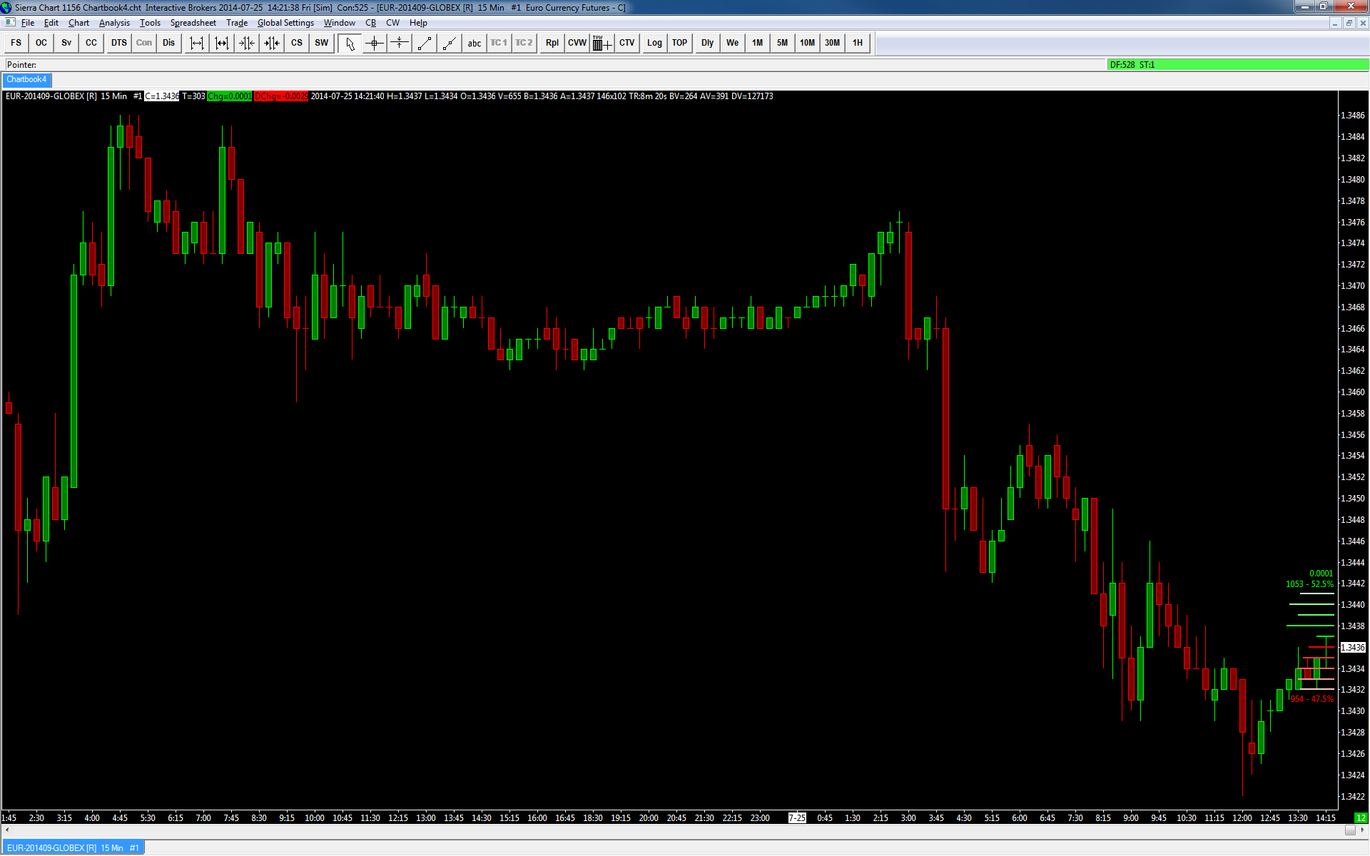

image1_Chart.png / V - Attached On 2014-07-25 18:22:33 UTC - Size: 96.26 KB - 518 views
[2014-07-25 18:49:24]
We have discovered the source of the problem and it will be resolved in the next release.
