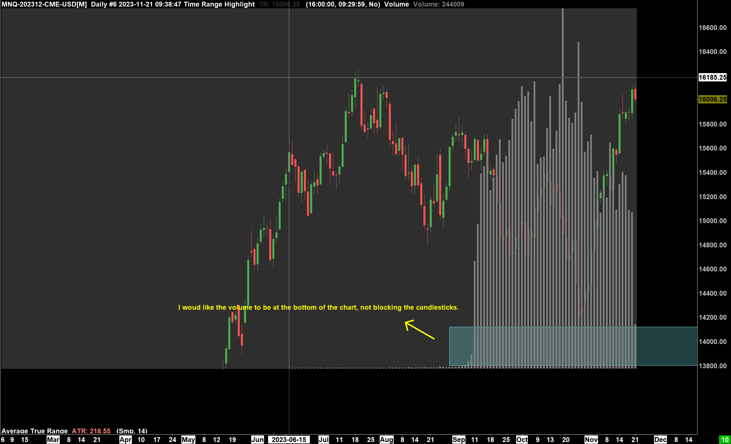

I want to save real estate so I don't want the volume bars underneath the Graph. I want the volume to overlay and sit in the graph.
I was able to figure this out, however I can't fix the scaling of the volume graph. I would like to make it smaller and sit at the bottom of the graph consistently. Right now its taking up the entire screen, and hard to see the candle stick.
https://www.sierrachart.com/image.php?Image=1700577528683.png
Thank you

The easiest solution is to put the Volume study in a different region. This way it will definitely not overlap the main price bars. Refer to the following:
Chart Studies: Settings and Inputs Tab >> Chart Region
If you really want it in the same region as the main price bars, but you want to change the scale, then you will need to do the following:
- Turn on the Left Side Scale. Refer to the following:
Chart Settings: Use Left Side Scale (Chart >> Chart Settings >> Scale menu)
- Set the Volume study to be an "Independent" scale. Refer to the following:
Chart Scale and Scale Adjusting: Independent (Scale Range)
- Set the Volume study to use the left side scale. Refer to the following:
Chart Scale and Scale Adjusting: Use In Left Side Scale
You can then adjust the height of the Volume study by adjusting the left-side scale.
