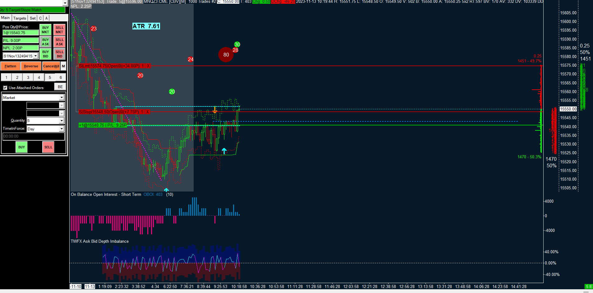

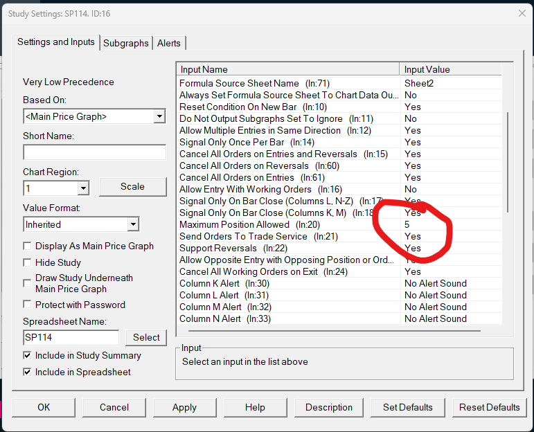

Hello, I've 3 Spreadsheets for Trading, each on a separate graph. All on the same Ticker: MNQ. I've defined Send Order to "NO" on each of these 3 spreadsheets.
I've created a fourth Spreadsheet for Trading where the buy signal is OR(BuySystem1, BuySystem2, BuySystem3). Same for Short. I've defined max position as 5 in the 4th Spreadsheet. In the Trade Window, I've defined quantity as 5. The system (#4) takes trades with Stop Loss and Target as expected, but with a Quantity of 1 and not 5. What did I do wrong? How can I make him send orders for 5 instead of 1 please? THANK YOU.

When using the Spreadsheet System for Trading study, the quantity is set in J26, not on the Trade Window.
[2023-11-13 15:22:51]
User347921 - Posts: 39
Thank you very much. It works.
[2023-11-13 15:32:01]
Sierra_Chart Engineering - Posts: 25470
You need to set the order quantity with this Sheet cell:
Spreadsheet Systems, Alerts and Automated Trading: Order Quantity (read / write) [v1:J26, v2:J69]
