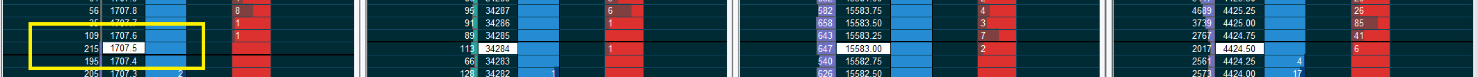

Dear SC-Team,
I duplicated the Chart DOM on the left side (yellow marking on the picture) and the middle line is not displayed correct- one tick under the other middle lines.
Please help me to fix it.

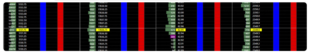

Dear SC-Team,
The horizontal line will be drawn at the middle of the DOM (right between the best bid and best ask).
On the screenshot you can see three DOM's with the middle line above the current price and one DOM with the middle line under the current price (yellow rectangle on the screenshot).
Can you please help me so that all four DOM's have the middle line above the current price?
imageScreenshot 2023-11-11 112823.png / V - Attached On 2023-11-11 10:40:35 UTC - Size: 26.17 KB - 334 views

[2024-05-27 19:56:49]
This is impossible for us to help with. You cannot get the Middle line exactly in the same position on every Trading DOM. There are just too many variables involved. This is not within the scope of our support.
