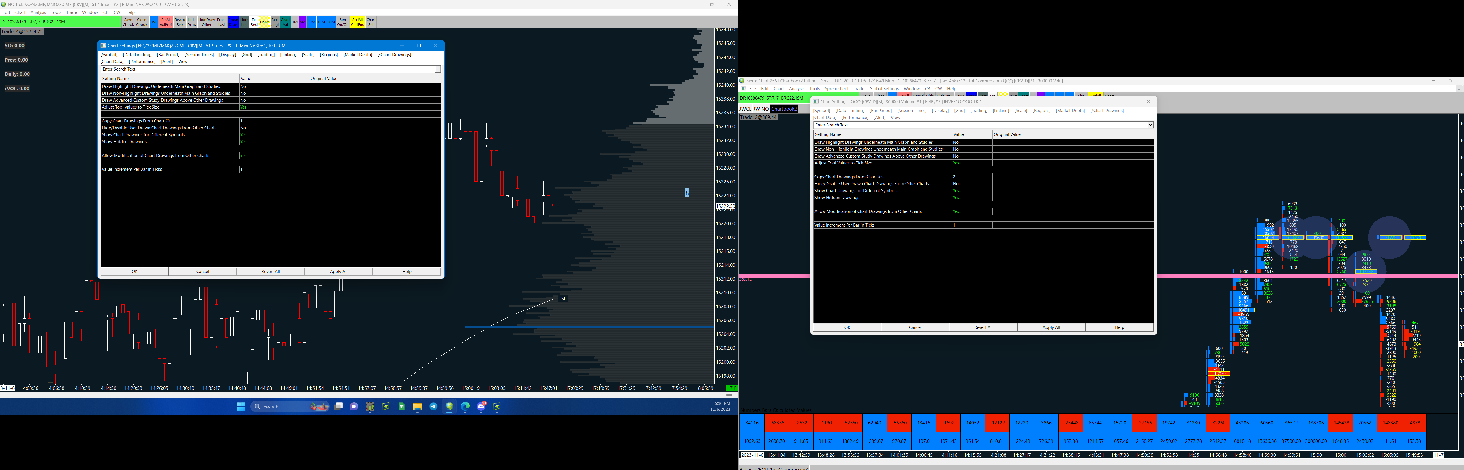

I cannot get the drawings from this QQQ footprint chart to cop to my NQ tick chart. I checked everything twice I do not know what I am missing. Please help.

Keep in mind that the prices between those two charts are very different, so the drawings are probably being copied properly, but they are at a price that is so far away from where the bars are that you are not seeing them.

Oh I see. Is it possible to draw a box on QQQ and have it copied onto NQ at the current NQ price?
No, there is not a way to do this using the Drawings.
You could use the Horizontal Lines study (or another study that has what you need) to create a couple of horizontal lines and then use the "Study/Price Overlay" study to overlay that to the other chart. The Study/Price Overlay has a "Multiplier" input that you can use to adjust the data to the price you want. Refer to the following:
Horizontal Lines
Study/Price Overlay Study
