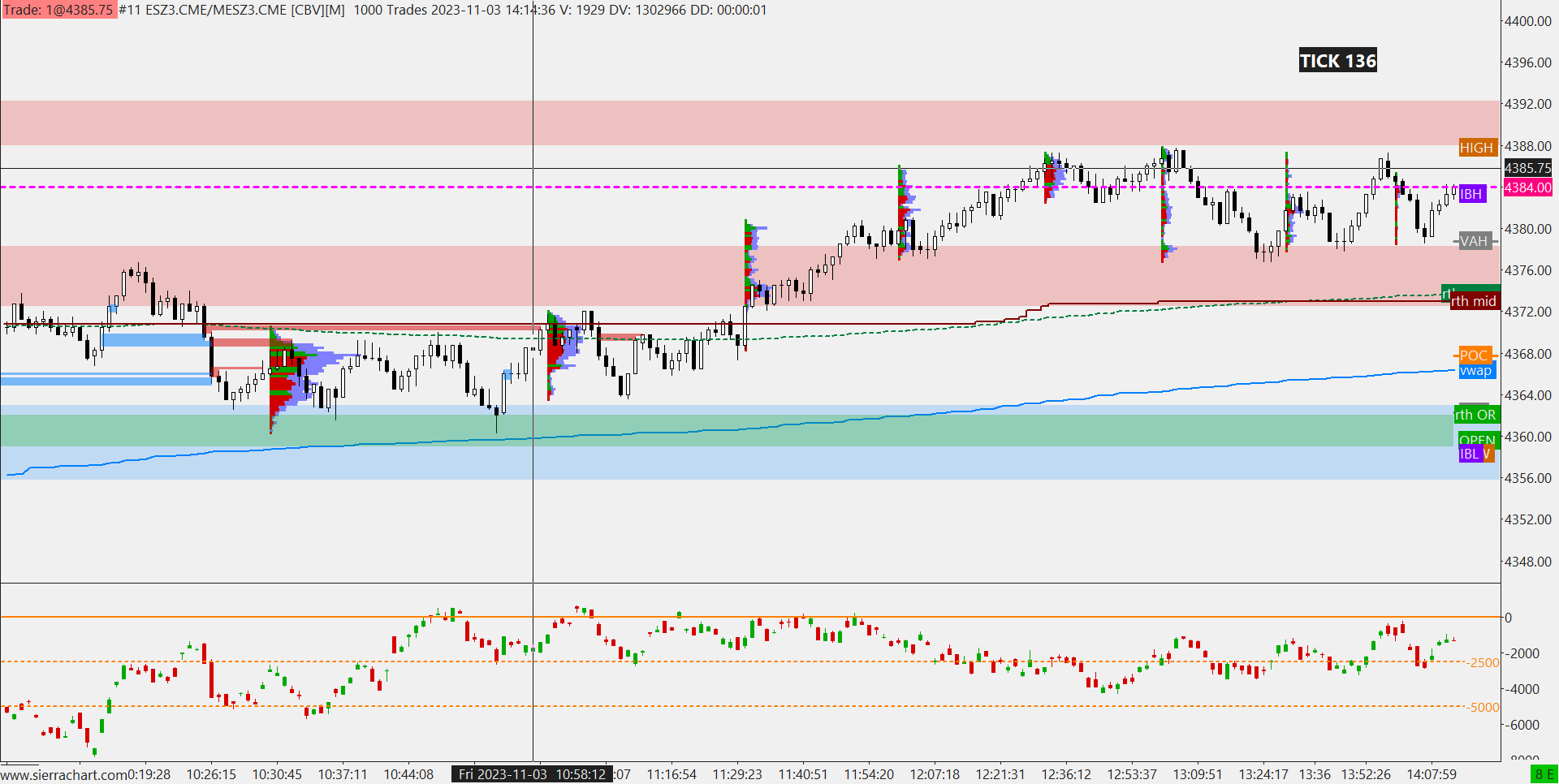

Is the rolling cum delta supposed to look like this? Length set to 25.
I tried it last week I think, and it did not look like this.. (I am quite sure about that).
https://www.sierrachart.com/image.php?Image=1699035278495.png
Regards Anders

If you recently updated Sierra Chart from an older version, then there will be a change. There were problems with the rolling functionality with that study. It was never implemented correctly.
What you see must be correct. But to be sure, re-download some recent data:
Data Errors or Spikes in Charts, Flat or Flat Line Graph, Compressed Graph, Errors with Date/Time Values: 2.1.2 Deleting and Re-downloading Data. (Easier and Recommended Method)

Anders Dybdahl - Posts: 26
Thanks for your reply, I tried delete and download data but no change.
I did notice that the older version did not function properly, with bars expanding.
I then updated, and it seemed to work fine, the delta bars PRIOR to the set rolling length was printed as normal ask-bid difference bars centered around the zero line, which makes sense. But now it's all over the place.. It should not gap between bars? I did change my global time zone to NY time, but that should not be an issue? Anyone else using rolling calculation out there - how does it look on your end?

No this is definitely not true, a gap would be fully expected:
With the rolling calculation, Cumulative Delta is calculated independently for each and every bar.
