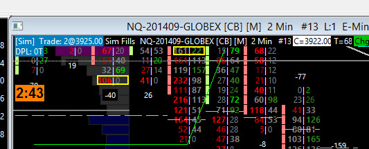

Dear All,
There are occurrences when CountDown Timer added into 2 min time-frame chart displays more than 2 min as time remaining (see enclosure) and and sometimes in the same chart restarts with every new bar as 2:00 min remaining.
What could be the issue for this inaccuracy?
Thanks a lot.

I have the same problem in a long time. CountDown Timer displays the time which isn't synchronized with the moment when bar has closed. It occurs at 1, 5, 15 min time frame.

In both of these cases your computer's clock is not set accurately. Refer to help topic 38 here:
Http://www.sierrachart.com/index.php?page=doc/helpdetails38.html

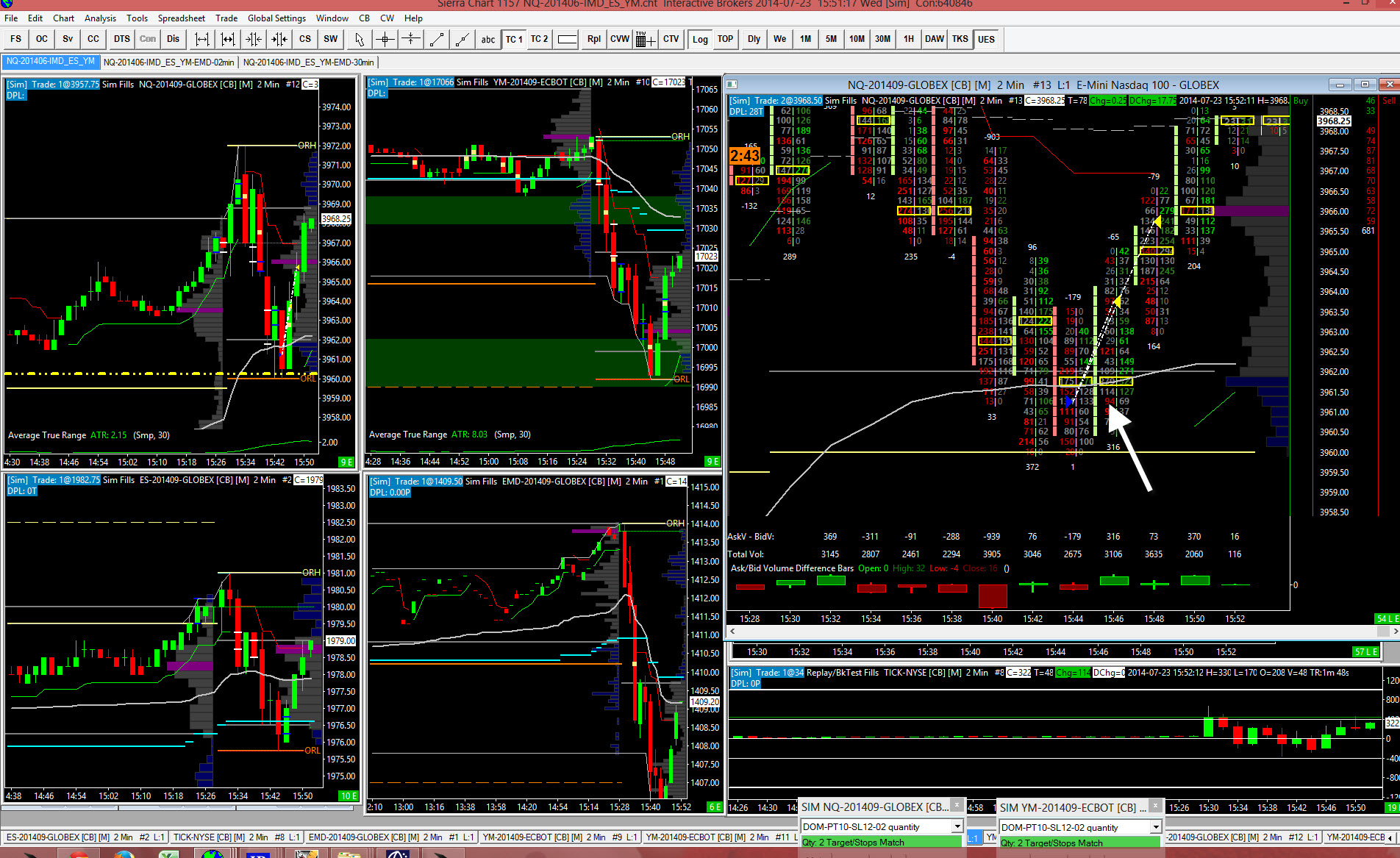

I realized today when running replay that timer is set correctly to 2:00, but during real time session it starts by every new bar at 2:55. Another indication is that my entry in the trade is displayed on the previous bar than it was really filled - please, see the white arrow in the enclosure.
image20140723-SIM-NQ-01-Long-wrong bar displayed.jpg / V - Attached On 2014-07-23 14:44:20 UTC - Size: 885.58 KB - 914 views
[2014-07-23 17:13:59]
Your computer's clock is off by approximately 1 minute. Check it.

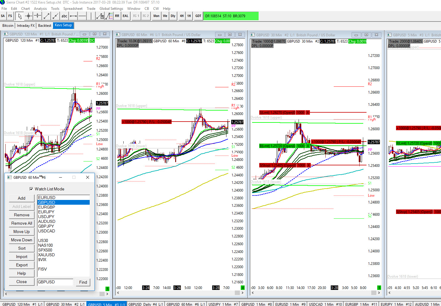

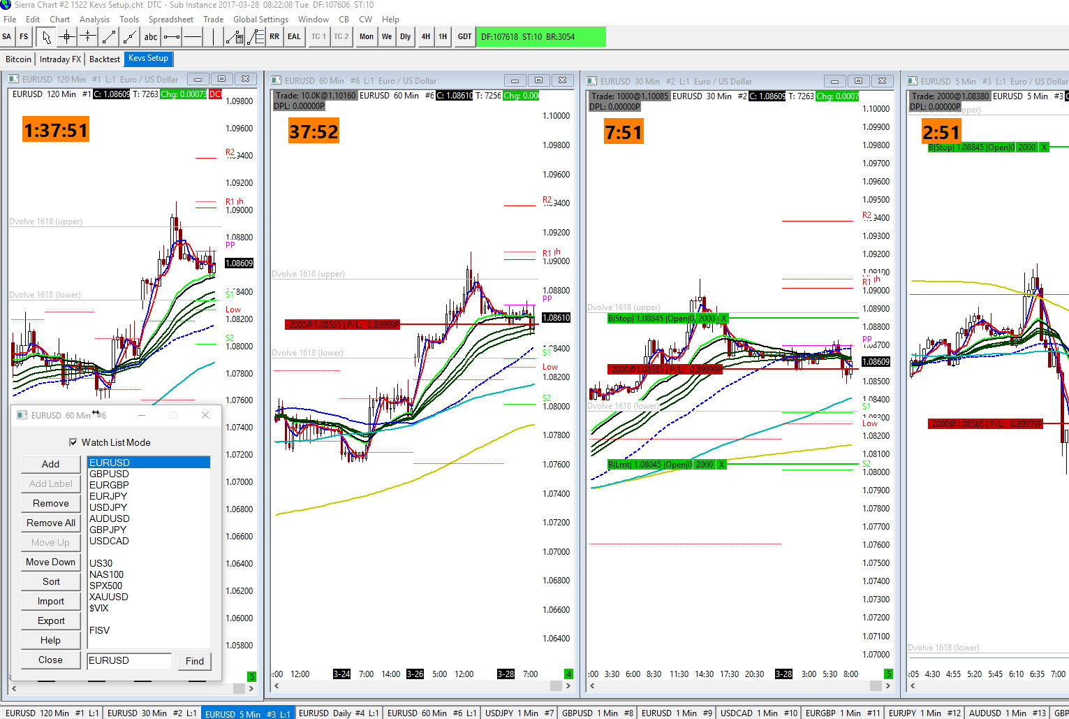

Just noticed that although I have saved this study into my study collection which are applied to all of my charts, when I switch charts (Click through my Watch list symbols), the study disappears? But when I go back to the symbol I added it to initially, it is there. I think that I misunderstanding either the location on this study or there is a bug in the way it is drawn ad which charts it is drawn on. See attachments.
Date Time Of Last Edit: 2017-03-28 07:24:52
imageOn EURUSD.jpg / V - Attached On 2017-03-28 07:23:44 UTC - Size: 526.69 KB - 807 views
imageDisappears when switching to GBPUSD.jpg / V - Attached On 2017-03-28 07:23:55 UTC - Size: 522.49 KB - 714 views
[2017-03-28 07:42:50]
In response to post #10, refer to the documentation for these Inputs here:
https://www.sierrachart.com/index.php?page=doc/TechnicalStudiesReference.php#s201
The behavior you see is already documented.
We will look into this.
[2017-03-28 07:56:51]
CarlRostron - Posts: 80
Thanks - the documentation now explains this, Appreciate the pointer, I did start to look at this just now before you replied.
Yes, the chart changing is an issue. My work around for now is by having the timer in Region 2 at the bottom of my chart and this no longer present an issue on changing charts.
[2017-03-29 17:41:45]
The problem of the Countdown Timer not appearing when changing the symbol of the chart is resolved in the latest release.
