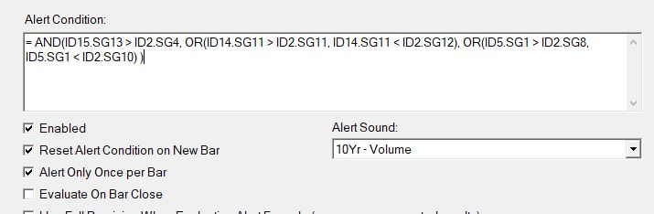

I don't know how to recreate the formula so I tried to link the alert to when the colour is highlighted but I don't think "In:21" works the way sub graph links do. (pic 2)

You can not set an alert based on an Input, nor can you do it based on coloring. You have to use the underlying information to create the alert.

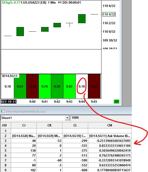

I currently have the Total Volume from Numbers Bars Calculated Values highlight in colours when the ranges are hit (pic 1 above). I want to create a specific sound alert that triggers the same time each colour highlights. So one sound alert for Range 2 and another for Range 3.

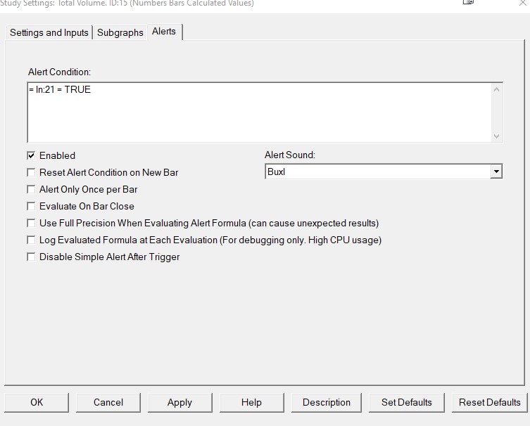

I set up this alert up and it works because in some cases it will trigger, but in others it won't and I can't tell what the issue is. Can you tell from looking at it?

We do not see anything wrong with the syntax of what you have written, but with the 2 OR statements within the AND statement, it is a bit complicated, so you need to make sure you have it working as you expect.
The Spreadsheet Formula uses the Alert Syntax (despite its name). Use this to breakdown your formula and look at each piece and build it up. It will help you figure out where you may have something not set exactly as you want it. Keep in mind that with something like =AND(a, b) the Spreadsheet Formula will return either a 0 (false) or 1 (true). Refer to the information here:
Spreadsheet Formula

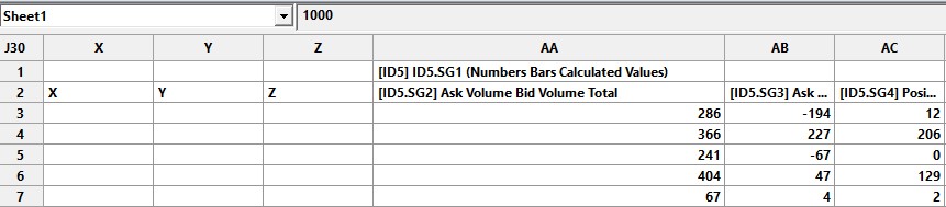

The first its its missing an SG1 from a column (issue 1 screenshot)
Then it keeps skipping the second last minutes data in the row 4
Any ideas?

We are not sure what you are looking at in the Numbers Bars Calculated Values, but refer to the following:
Numbers Bars: Referencing Numbers Bars Calculated Values Subgraphs in Alert Formulas
